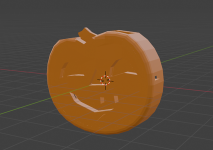

Step 1: Download the CAD File
First, download this CAD file. This CAD file is what we will use for the build.
This CAD has 2 modes: compact mode and spacious mode. If you want to make it spacious, print 2 front covers. If you want to make it compact, print 1 front cover and 1 back cover.
Use a 3D printer to print it out. The files are already in stl. These files are dimensionless, so if you slice, ensure you allow the software to convert to mm. You can also scale as needed.
