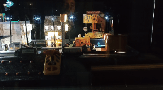

Welcome dear reader. Halloween is one of my favourite holidays, not only because that's when my birthday is and have a cat named Pumpkin who we got on on Halloween, but also because of its traditions, spooky fun, creativity the community involvement. This year I wanted to make a stand alone Halloween decoration with a difference, something that uses simple materials and tools to make, but also something the young 'trick or treaters' can look at and interact with. Another reason I made this was because, I don't know what it's like in other parts of the world, but here in the U.K Christmas decorations go up days or weeks before the big day, yet Halloween is only really done for a single day, so I wanted to make a decoration display that can be on show for a bit longer. It sits on its on 4 easily removable legs or can sit on its on on a table, the floor, work surface or a large shelf.
I came up with the idea of a miniature town where only ghosts and ghouls live and shop, with horror themed shop and vehicle names, each with a scary monster or two behind the windows (and one human who is trapped crying for help). There are two remote control trains running on a wooden track, two cars that run on a road (more wooden track), and an outdoor cinema that shows scary movies using a spare smartphone. There is also a motor controlled Merry-Go-Round (carrousel) called a Scary-Go-Round that from a distance looks like it has regular horses but when you get closer, you will see that they are actually wolves. On one of the buildings there is a 'Broom Pad' (like a Heli Pad) where Witches can land and take off with some rotating Witches flying around in a holding pattern waiting to land and do their shopping, and the whole town has lighting that can be controlled from a control panel with red push button switches... because we all know that kids like to push buttons. There are embedded flickering LEDs in the base where resin made pumpkins can sit on to give a candle lit effect, upstairs and downstairs building lighting, illuminated shop signs which are all horror themed, and removable street lights. The 'Scary-Go-Round and vehicles also have lights as well.
I designed the town so it is modular, meaning that all of the buildings and street lighting can simply be disconnected from the base, stored in a box and the base itself can then be stored upright in a cupboard taking up little room ready and waiting for the next year (or you could leave it up all year round if you like).
The Inspiration:
I've always liked the miniature tabletop Christmas villages you can buy which has the little moving items like sleighs or little Xmas trains with snow covered trees and twinkly LED lights, so I took the inspiration from these to make a larger Halloween version. We also have regular 'Trick or Treat' visitors from the local neighborhood every year so I wanted to make something that stands on it's own with removable legs that would be displayed it in a window (see the last 4 photos/GIFs in step 18) for a week of so before the 31st, then set it up in our hallway by our front door (or just outside if the weather is good) so the local kids and their guardians can explore the town and have a quick play with the lights and trains.
Another part of the inspiration I got was from the TV show 'Bobs Burgers'. If you watch it then you will know, but for those who have not seen it, the shops in the town the characters live in all have funny pun-based names and descriptions such as 'You Can't Handle the Tooth - Dental Extraction' and 'Takes One to Mow One - Landscaping Supplies', so I wanted to give this a go for the shops in my little town, but Halloween/horror based.
The Build:
Apart from making this as a personal project, I designed and made it for the Instructables community as well, and as everyone has their own skill sets and making abilities, I set out to make this only using inexpensive and easy to use parts, materials and tools and to make and publish the project hopefully in time for Halloween 2025 for anyone who wants to make their own. This project mainly uses foam core/foam board, LED lighting, paper, double sided tape and hot glue. I also opted to use wooden train track which I originally was going to make myself and did successfully make a small section of using a router and some 12mm MDF, but after weighing up the cost and time of making track, I decided to opt for buying some second hand track and vehicles which I got as a bundle form an auction site. It worked out cheaper, had vehicles/trains I could use parts of, there were plenty of people selling some, and I also figured why use new wood when there are plenty of used stuff available which could possibly end up in landfill if it never sold.
As for the rest, the main electrical system is 12 volt (vehicles are 3 v battery powered, 2x AA batteries) and all of the lighting uses LEDs so it is all low powered, no heat and safe. This is a project that you can get the kids involved with and have some real fun designing and making everything (with adult supervision of course as we are using sharp knives, scissors, hot glue and electricity). And if any part of the town should get damaged by over eustatic little hands, then the parts are easy to repair or remake.

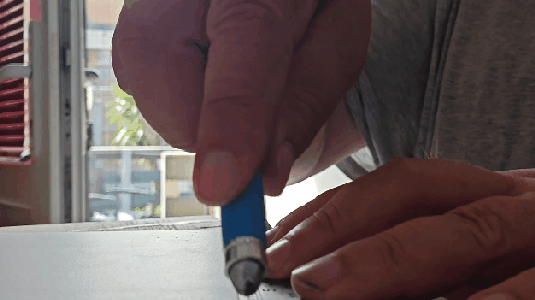

Before we start, as we will be using a lot of it in this project, here are some tips on successfully cutting foam core/foam board.
Basics:
  1. Use a fresh knife blade to start, line up your metal edge ruler along the cutting line and make a slow, light score cut first.
  2. Then make 3 or 4 more slightly firmer cuts until you're through.
  3. Don't try and make the cut in one pass,
  4. Keep firm pressure on the ruler,
  5. Check and double check that your fingertips are clear of the cutting line
  6. When you start to feel pressure on the knife and the cut become less clean, change the blade.
  7. And keep focus on every cut, cutting slowly. Even with a sharp blade and a firm cutting edge, it is still easy for the knife to drift and wonder and cut away from the rulers edge.
Freehand Cuts:
  1. For round cuts use a plate or cup etc. as a cutting guide. But sometimes making round cuts or cutting small pieces, it is necessary to do it freehand.
  2. Hold the knife firmly between your fingers with the knife at around a 45 degree angle.
  3. Make a slow score cut along your pencil line.
  4. Then make multiple slow, light passes with the knife. The score cut will help act as a cutting guide.
Curved/Arched Cuts:
  1. Foam core by its nature is a ridged material and will crease when you bend it. But like good quality plywood, you can get foam core to bend. The technique is called kerfing which is multiple light cuts through the board.
  2. To make a kerf cut on foam core, lay the sheet on a cutting board and lay on your metal ruler.
  3. Using the same cutting technique above, lightly cut through the board until you reach half way through.
  4. Move the ruler up slightly and make a similar parallel cut.
  5. Keep going until you reach the end of where you want the curve to end.
  6. The closer the cuts are, the tighter the curve, but there is a limit so keep that in mind.
  7. Take your time and make sure you have plenty of light when doing these cuts, and take a break on larger pieces. The last thing you want to do is cut completely through the board when you're half way through or more.

Step 6: Lightbox Signs:
All of the light box signs are made the same way, but with different design drawings and sizes. I drew the signs with a paint program on my laptop and printed them off. But if you prefer you can hand draw the signs which will work just as well.
  1. Using your building covering pictures as size templates, draw your signs and resize them so the will fit to the front of the buildings they are for.
  2. When the sign drawings are finished, add some overlap. For example, draw a black border which will be the overall size of the sign, give it a coloured background, orange for example, then the sign writing. This will be the front of the sign. The draw a larger border around the sign, this time the same orange you used as the background, then use the paint fill tool and fill the the gap with the orange.
  3. Print off the sign and cut out.
  4. Measure the the sign (black border) then mark and cut some strips of white foam core making the width of the pieces a little wider than the LED strips.
  5. Glue the pieces together to make the light box frame.
  6. Attach double sided tape to the back of the sign so the tape is just outside the black border which you should see through the back of the paper.
  7. Remove the backing paper, lay the sign face down on the work surface, then carefully light up the box frame over the sign and attach.
  8. Fold the overlap along the top and bottom of the sign, make four scissor cuts where the paper overlap folds on each corner, then fold and stick the overlap to the sides.
  9. Remove the backing paper from the back of an LED strip and stick it to the inside top of the light box.
With the light box finished, simply pierce a hole with a screwdriver or similar onto the building near where the sign will go (this hole will be hidden by the sign), feed the LED wires through the hole, apply hot glue around the edge of the sign and attach to the building.

Step 12: Scary-Go-Round:
To make room for the motor and the power socket, the merry-go-round sits on a hollow base platform. This has its own separate battery powered lighting. I played with a number of ways to make this such as turning the ride with a motorised wheel to turn the platform and have a slip ring in the center to power the lights from the main 12v power source. But this proved to be tricky with the space I had spare so I opted for a direct drive (motor shaft to center of the platform) and separate light system. Here's how it was done.
  1. Measure out a square piece of foam core slightly larger than the disks, and them four sides. Cut these out and clue together to make the base. I used black foam core and highlighted the edges with a silver acrylic paint pen.
  2. Measure and make a hole in the center of the base, turn it up side down and glue the DC motor to the base with the shaft poking through the hole.
  3. Using a drawing compass, draw a circle to the rough size you want for the ride's platform. Then use a plate or dish roughly the same size to use as a cutting guide, place it onto the board so it is centered to your marking, then make multiple score cuts until you're all the way through. Make four equal size discs.
  4. Cut out a length of foam core (any colour as it will be covered), and make kerf cuts the fill length of the piece.
  5. Glue this to one of the discs all the way around. Cut off any excess if it's too long, or add an extra kerfed piece if it's not long enough.
  6. Now glue a second disc to the other edge of the kerfed panel. We now have the ride base.
  7. Glue a large metal washer to the black base around the motor shaft, and another washer to one of the glued disks, around the compass hole. These washers will support the ride and make for a quiet running.
  8. Cut three equal length foam core strips, one wider and two narrower. Then cut six drinking straws the same length (cut off the bendy bits). Glue the three strips together to make a '+' beam support.
  9. Make four equally space holes into the third unused disc and insert two green and two red LEDs. Wire them together in series (all red positives together, all black negatives together. Then connect the AA battery holders black negative wire to the LEDs either by soldering with heat shrink tubing or using wire connectors.
  10. Make a second kerfed length and of foam core and glue it to the disc.
  11. Make a light box sign for the ride (mine is not actually lit because my last LED strip broke). Make a large hole in the top of the sign and a smaller one in the bottom. Insert a push button latching switch through the larger hole and feed the wires through the smaller hole.
  12. Draw a covering for the top cover and stick it to the forth disk. Make a hole through the center, feed the switch wires through and glue the sign to the top panel.
  13. Connect the red positive LED wire to one of the switch wires, then the other switch wire to the red positive battery holder. Now glue the battery holder to the inside center of the top cover. Make sure it is centered as this will help balance the ride. insert batteries ant test the lighting.
  14. Glue the support beam to the center of the lighting disc then glue the six straws equally spaced around the edge making sure they are as straight as possible. Add glue to the other ends of the support and straws then attach to the ride base.
  15. Now dress the ride with your ride pictures, and made the same way as the Witches in step 8, make the wolves for fair goers to ride on, gluing them to the outside of the straws, some lower, some higher.
  16. Finally, make the hole in the base of the ride a little larger, but smaller then the motor shaft. Apply a little hot glue then insert the ride onto the motor shaft pressing firmly so there is a tight fit between the shaft and the hole. Hold the ride straight for a few seconds while the glue cools. The ride should be sitting straight as the washers will help support everything.
Just to note, the top disc panel is not attached to the ride so it can easily be removed to change the batteries. For some finishing touches, I made some steps up to the ride, and made a little see-saw ride out of some foam core scraps, coloured in with acrylic paint pens and glued a couple of ghost residents on. It doesn't move, it's just a display piece.

  2. Cut a couple of side pieces of foam core (the lower quality stuff is better for these small pieces), offer one up to the side of the loco and mark out the size/shape you want it. When deciding height, make sure you leave enough ground clearance.
  3. Now measure and cut a front and back panel and glue the pieces together. The idea is for the foam core frame for the loco to be press fit onto the drivetrain. The same would need to be done for the road cars but the carriages can be press fit and glued into place. Depending on the loco design, the loco press fit frame allows it to be removable to change the batteries.

Step 18: Finishing Off:
Base board done, buildings done, vehicles done, electrical work done... all that's to do is assemble everything and dress it up.
  1. The last build job was to cover the base board frame with the skulls artwork I did for the control panel. Simply print or draw some onto A4 paper, cut some strips off to size, apply double sided tape and stick to the frame.
  2. To make the cinema movie clips montage, I went through my horror/scary movie collection and screen recorded some of the clips I wanted and put them all together using a video editor program on my laptop. Then transferred the video to the phone and play it on a loop. You could just play some online movie clip videos from YouTube etc. or just play a single movie, but keep in mind the viewing audience... not the towns ghostly residents, but the children who will be looking at it. We want it a little scary as it is Halloween, but not to the point where we want to give them nightmares so please keep this in mind.
  3. Plug in and place all of the buildings, streetlights and 'Scary-Go-Round, then power it up.
  4. Power up the vehicles and let them roll.
  5. Place the pumpkins over their flickering lights (if you haven't already hot glued them in place).
  6. Add some more characters to the streets, train station, fairground and cinema. I chose not to glue the characters down so kids (or interested adults) can move them around or my family could give them away with the parents/gradians consent of course.
  7. Then the last thing to do is wait for the viewers and trick or treaters to come and visit.
The idea of this decoration display was for it to sit on its own to display in a window in the lead up to Halloween, then move it to our hallway near the front door, or put it just outside the front door if the weather is good, on a table for visitors to take a closer look and have a play with it.
And there we have it. Something a little different, some work involved to be sure, but totally worth it in the end and a great project to get the kids involved with as it is something they can help make, having fun and learning new skills along the way, and then get to play with. And of course it makes a great talking point for Halloween visiting neighbours. Future plans, after this year (2025) I will see how it goes and may make some changes such as making more details for the buildings, other fair ground rides, and may even add a second layer. If I do I will be sure to make another Instructable detailing the process. If you do decide to make your own spooky town or village, please let me know in the comments with photos if you can.
