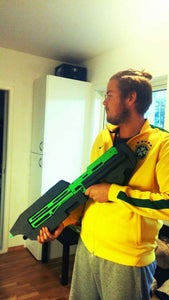

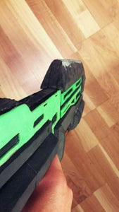

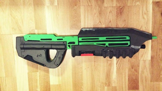

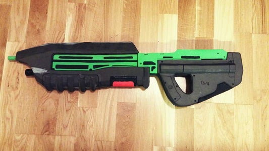

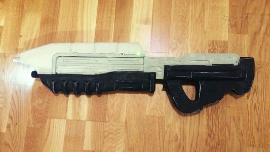

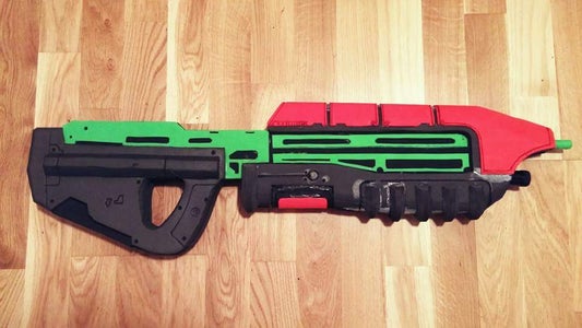

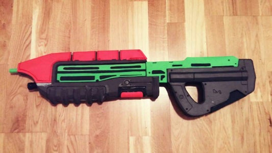

Step 1: The MA6C Rifle Prop

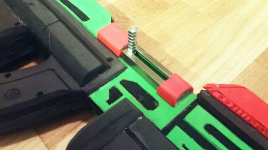

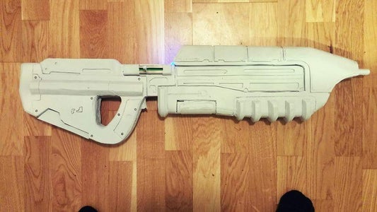

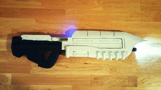

The MA5C Rifle is made entirely out of EVA foam. I made the rough shape with 3 layers of EVA floor mats. I then proceeded with detailing it with thinner mats of foam. For the bolt shin i used an old door lock and modified it. When all the details was added i added several coats of plasti dip. Then primer and then i painted it with acrylic paint and sealed it with a water resistant clear coat.

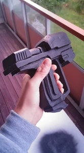

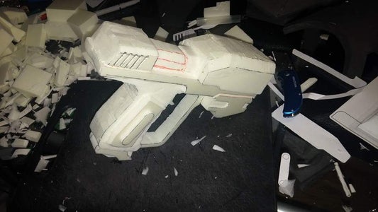

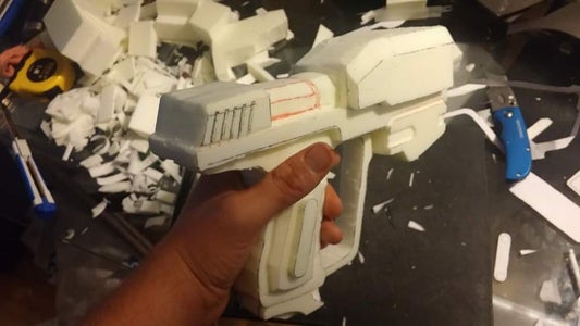

Step 2: The Magnum Gun Prop

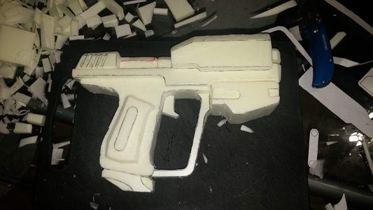

The Magnum gun is carved out in one solid block of styrofoam. It took me approximately one week to finish. Coated it in plasti dip and painted it.

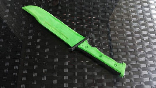

Step 3: The Knife Prop
The knife is made out of three layers of thin craft foam. I reinforced the blade by adding popsicles to the middle layer.

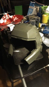

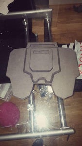

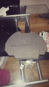

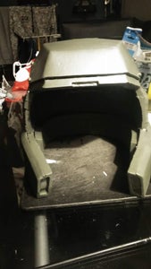

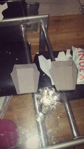

Step 4: The Armor
The armor is exclusively made only out of EVA foam floor mats. I carved in any details with the dremel or a knife. After detailing the armor was plasti dipped, primed and painted with acrylics.
