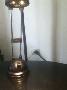

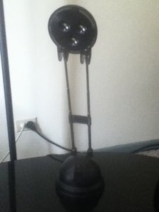

I have this halogen desk lamp that I use often but the bulb goes out every couple of years. I have always thought that our Cree 3W Dimmable LED Puck Light would fit nicely in the housing. So I decided to try it and I really enjoy the outcome. Now, my desk lamp supplies nice light without getting as hot or blinding as the original halogen bulb and I doubt I will ever have to deal with it going out again. In addition, it was very simple to do and it only takes about half an hour.

Step 1: Disasemble Original Bulb Fixture
First step is to take the old fixture out. You can do that by unscrewing all the mounting screws. This is the time to inspect the lamp and see if you can find the voltage and power of the transformer. Luckily for me, this lamp was 12v and 20w, which is perfectly within working range for the Cree 3W Dimmable LED Puck Light. Notice that my lamp transformer works in A/C and usually with LEDs' you will need to use D/C but the puck I am using has a rectifier so it is irrelevant weather you use A/C or D/C.

Step 6: Mount the Puck Into Place
After the new puck is wired up is a good time to test to see if it lights up. If/when it works, mount it into place via double sided tape or screws and you're done!
