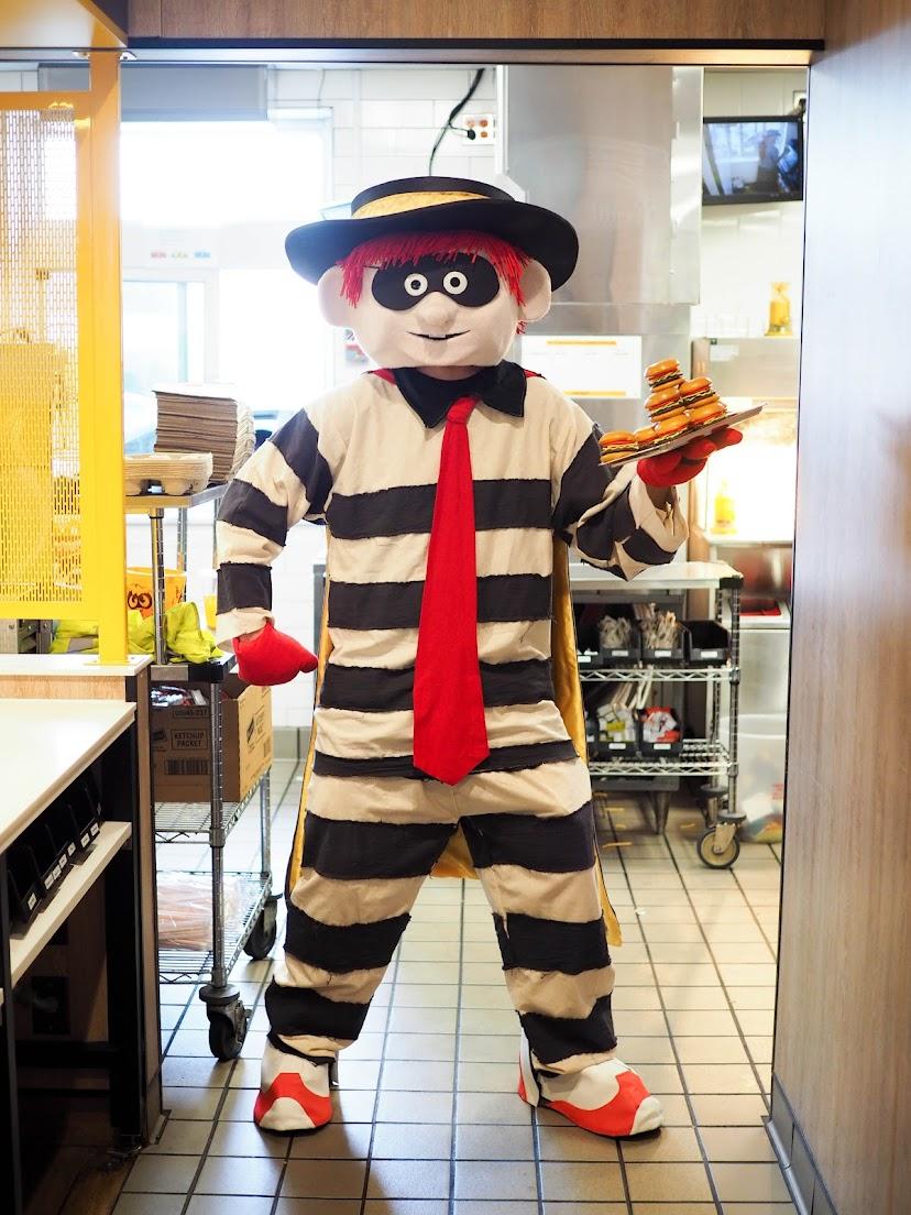

Introduction: Hamburglar Costume Build
I had never done a mascot type costume, and after discovering McDonald's had shelved the burger man due to his crime ties, it seemed like a fun build.
There are plenty of different variations on Hamburglar. I picked one I liked best and made a list of the separate costume parts and how I planned to create them. Most of the Hamburglar images are cartoons, so there's a lot of interpretation. We have hat, head, shirt, cape, tie, pants, gloves, and shoes. I needed a prop so I bought a silver tray and ten fake plastic hamburgers.
I start with the most critical components, liked the head, and put less critical items like shoes last.
All of the foam pieces are heated with a heat gun to close the pores. This makes gluing and painting easier, though I don't always heat treat before glue up I always heat treat before paint. The only thing I painted was the hat.

Step 1: Head/Hat
I started with the head as that's the most noticeable part of the costume. I used the foam mat edges to craft a headband that would center and hold the Hamburglar head on my head.
I used paper to determine the rough overall diameter of the head, then I cut a foam strip to match. The top of the head is a series of triangles at the four corners and squares to create the curved shape. Cutting rounded triangle shapes in the foam, create curves when you glue the edges together. With the bottom portion, I took several pie cuts out of the foam so that it would curve in and create a neck opening.
Everything is attached with contact cement. I brush it on, let it set for a few minutes and attach. If you let it get completely dry, you have one shot to get it right. You can glue it wet if you want to be able to adjust the pieces. Per the name, it glues on contact whey dry and tacky. The foam likes to absorb the glue. If it isn't tacky to the touch, brush on another coat so you get good adhesion.
I centered the eye holes on my eyes to maximize visibility. The nose are scraps of foam built up to resemble the nose. I cut out the front and side profile in foam, then filled in gaps and used a dremel to sand it down for final shaping. The upper lip is a piece of craft foam while the lower lips is another piece of floor mat to provide depth. The cheeks are two pieces of foam to build it up and using the dremel to round off the edge. I tapered the back to blend into the head. I used a band saw for the cut, but you could use a combination of belt sander, hobby knife, dremel. I wish I had made the thickness of the cheeks three mats. The ears are single thickness and heated to curve them into the right shape.
The hair is just strips of red craft foam. I taped strips together to make it easier to apply glue and then attach to the head. I didn't need to go all the way up the head, just inside the edge of the hat, so I made the hat before gluing on the hair.
The hat is roughly a 22" diameter circle while the body is 4.5" tall. I had to build the hat to make sure the hair was the right length and glued far enough up the head. I sprayed the finished hat with plasti dip and hot glued the yellow satin ribbon to it.
I started with the top strip of hair and glued layers underneath to give it depth. The forehead has two overlapping strips, while the rear has three. Heating the foam allows for 'styling' it. I thought about wig, but I didn't want something I would have to constantly adjust.
Once the hair was in place I wrapped the head in fleece. It has a fair amount of stretch. I started at the nose and worked around that. I sprayed the head itself, but also sprayed glue onto paper to use as a palette for more control on where the glue did and didn't go. I used a gloved finger to transfer glue from my palette to the head. With the nose, I did have to create a seam below the nose and down the chin. I wish I had paid more attention so that the seam was centered and straighter. I used a single piece for the face and front part of the ears. I used a second piece for the back and back of ears. I have a seam that runs along the edge of the ears and from the bottom of the ears down. I trimmed a little at a time as I was figuring out where to put seams and then to get the fabric to meet at the seams. I glued the fleece up to the bottom of the hair and cut away excess. I folded the fleece into the neck opening and glued it down. The seams hide best if you try to pinch them together while gluing down. I used a wood skewer at the seams in an effort not to get glue on the fleece. For the mouth, I carefully slit an opening and folded it into the mouth and over the lips. I used a black Sharpie to color inside the mouth and white craft foam as the single tooth.
The eyes are sunglasses lens painted white. I used a metal washer as a template to cut a perfect circle out of painters tape. The lens are hot glued to the head.
The eye mask is just a piece of black craft foam with a black elastic cord hot glued to the back of the mask. I did add a piece of craft foam to sandwich the elastic end for maximum reinforcing.
The hat is hot glue to the head, just in case I ever want to remove it.

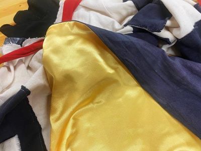

Step 3: Cape and Tie
I patterned the cape and tie in paper to ensure I had the right size. The cape is perm press dyed black with a gold satin inner lining. I sewed it inside out except for the top edge, turned it right side out, and then sewed the top shut. The top edge is folded over with the perm press over the satin.
