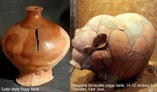

In case you're curious - some history on Piggy Banks (LINK).
