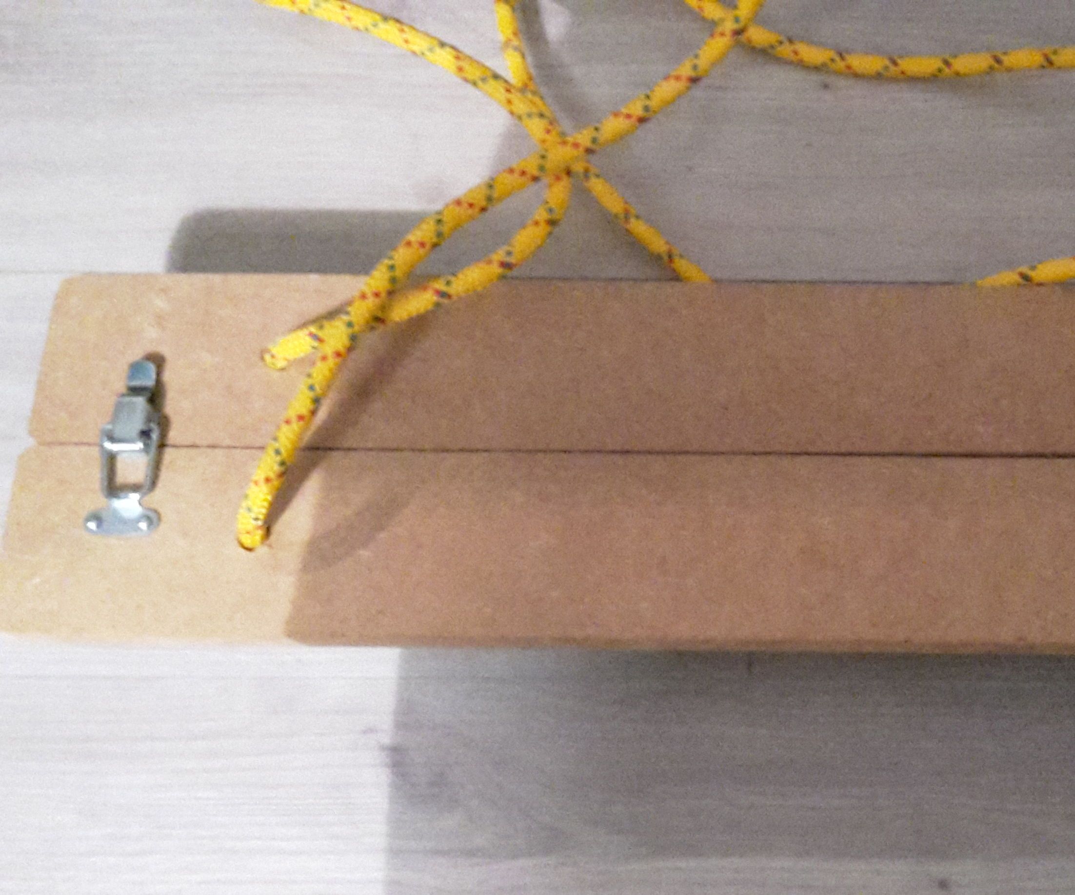

Step 2: Sawing the Piece of Wood and Drilling Holes
Because it's almost impossible to drill one long straight hole you have to saw the piece of wood so it's easier to drill holes into it.
The first step is sawing the piece of wood in 8 pieces of 10cm long each
After that you can begin drilling the holes, make sure you don't drill in the center of the wood but just on the edge like shown in the picture so that you have a small groove on one side.
If you're having trouble drilling it use another piece of wood and put it against the one you're drilling into as shown above. This will make it much easier to drill a perfect circle. I used a circumference of 22mm for 44mm thick wood
After you've succesfully finished drilling make sure the wooden stick fits.
Step 3: Drilling the Holes for the Rope
Now that you've drilled the holes for the stick, it's time to drill holes for the rope, take four pieces of the eight and drill hole on the top and one on the side of the bar, do this for all four as shown above. My rope is 6mm so for comfort i've drilled holes that are 8mm.
Step 4: Getting the Rope Attached and Assembly
This is the most difficult part, getting the rope through the holes. I used a smaller rope, tied a loop into it and used it to put the rope through. Make sure you have 4 pieces of 1m50 rope. So step by step:
- Take a smaller rope and tie a loop
- Put the smaller rope in the hole on the side and take a pencil f.e to take the rope out from the top
- After this put the normal rope into the top hole and gently pull on the smaller rope from the side
- Normally if you've done everything well, the rope should be through
- Tie a simple knot on the side so the rope can't escape
- Repeat these steps for the other 3 pieces
After all that assemble all the pieces onto the sticks, four for each side of course, and tie a double knot in the middle of each piece with the two pieces of rope on each end as shown in the picture. Use this just to make sure that everything fits. If everything dissasemble everything and go to the next step, you can leave the knots you've made.

Step 6: Glueing the Pieces Together and Assembling Your Swing
One of the last steps: Take your pieces of wood and assemble them like you did in step 4 but this time with the cloth of course. It should look like the last picture. If everything fits and you've checked everything it's time to glue the four pieces of wood on each side of the swing together. So dissasemble again and glue the pieces together, your result should be two bars each consisting of four glued cubes. After that slide in the sticks with the cloth and you're done! It should look like the last picture.
