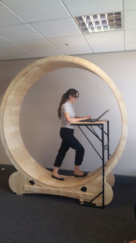

Things that are made to fit people are subject to lots of careful consideration. Ergonomics and safety are very important to any furniture project.
We considered adding in brakes but decided against it in order to really force the productivity out of the desk user. In the end, we decided on a wheel 80" in diameter that would be supported by a 24" wide base that contained a set of four skateboard wheels on which the wheel would rest. This design allows fluid rotation without requiring an axle for the wheel.
We already had a standing desk that fit through the wheel, so it was just a matter of avoiding interference and leaving enough room for a human.
The wheel was designed using Autodesk Inventor over the course of a few hours. This allowed for a parametric design, where the diameter, width, and number of slats could be changed easily. We imported a human model from GrabCad to check clearances, and measured every door at Pier 9 to ensure it could leave the building.
See attached files. This project was completed with 24 hours, and the files are somewhat lazy.
This project requires 4 sheets of ¾" Plywood, 4 skate wheels, 2 pipes, 240 wood screws, a pint of glue, and a good attitude.

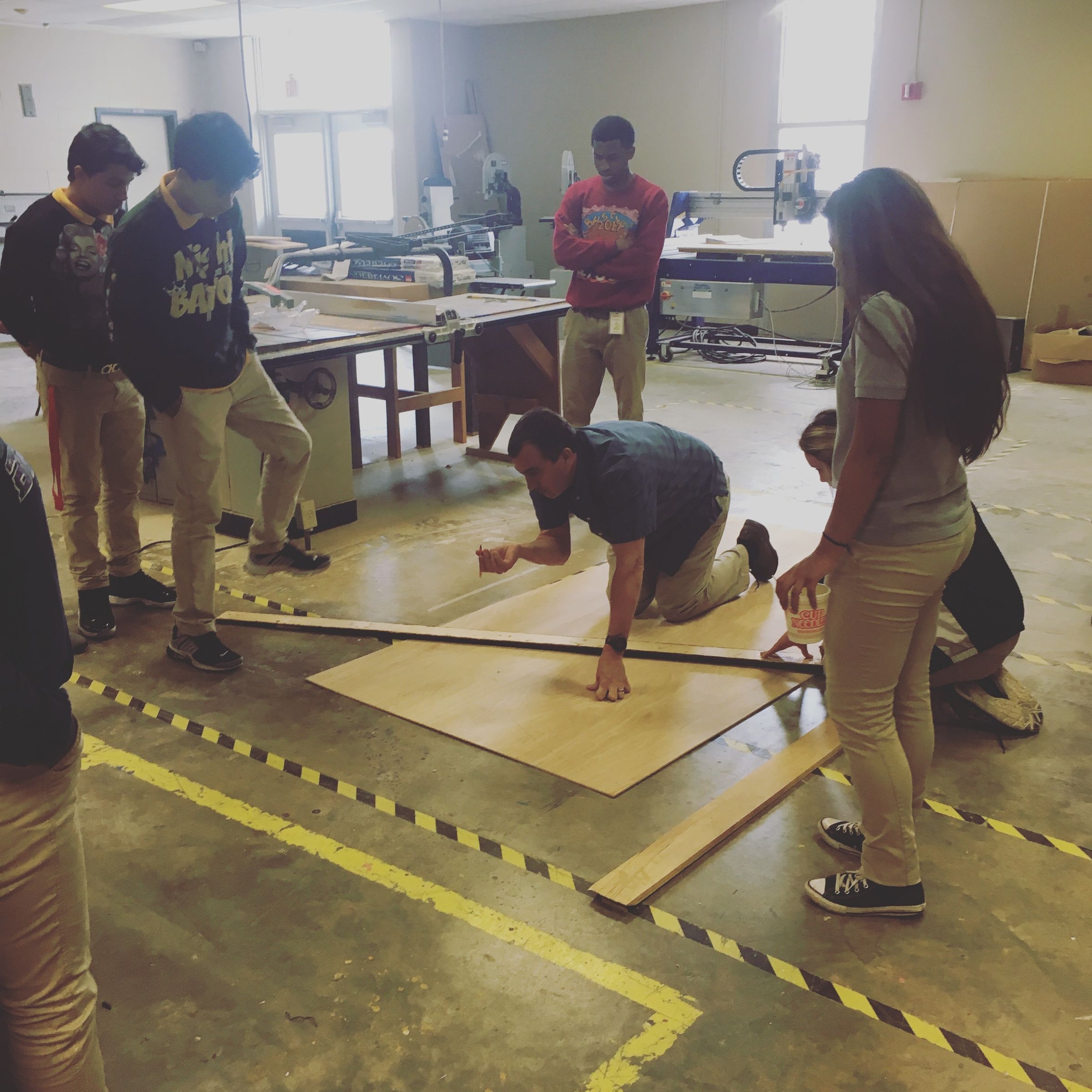

Step 3: Cut the Wood: by Hand
We used a table saw and chop saw to cut out the remaining slats of wood used to span the two rings of the wheel. There are sixty something slats in total. We used plywood because we had it on hand. 1"x6" pine would work great and look better, but cost more.
We cut the curved stand pieces with a jigsaw following a stencil we printed in sections. (Not pictured) Acrobat Reader can print the attached pdf as tiled pages. The precision is only important for the hole spacing and the distance from the axel to the ground. The slight arc on the base prevents rocking on slightly uneven terrain.

We then glued the layers of each ring together, staggering the two layers by 60° to maximize overlap and stability. Wood glue, when properly applied, can be stronger than wood itself. Initial clamping was done with ¼"-20 cap screws and T-nuts, followed by about 20 clamps. Glue was wiggled out liberally, spread with a piece of paper, then clamped to kingdom come. A sign of a good glue-up is squeeze-out, a small amount of glue emerging along the glue seam indicating complete dispersion of glue.
Step 6: Build the Base
The base consists of two large, hot-dog shaped pieces of wood, each of which hold two skateboard wheels.
The two plates are held together with tie-rods and steel pipes. 5/16" threaded rods inside the pipe pull the plywood sides together, while the pipes themselves keep them apart. The diameter of the pipe prevents skewing, and allows the base to be stable and svelte. The length of the pipe is key, and had to be changed a few times. Too short and the wheel won't spin, and to long and it wiggles too much. A very shallow and large hole the diameter of the pipe must be drilled in the wood to keep the rod near the center of the pipe. If the rod shifts, the plates will skew. There is no good reason why we didn't just use a 4"x4" piece of lumber and some wood screws, or any other easier method.
The skateboard wheels were attached to the base using 5/16 cap screws with two fender washers and two locknuts. As shown in the image, the first locknut should be super-tight, and the second a bit loose to avoid damage to the skate wheel. We tried placing a Delrin(plastic) disk in between each skateboard wheel and the wooden base to reduce friction between wooden rings and the wooden base, but ended up removing them to no effect.
Step 7: Test the Base
Once the base was assembled, we tested out the action of the rings on the base to ensure they spun freely and didn't hit the pipes or catch on jagged edges. Resist the urge to use the ring as a Cyr Wheel, it will not end well.

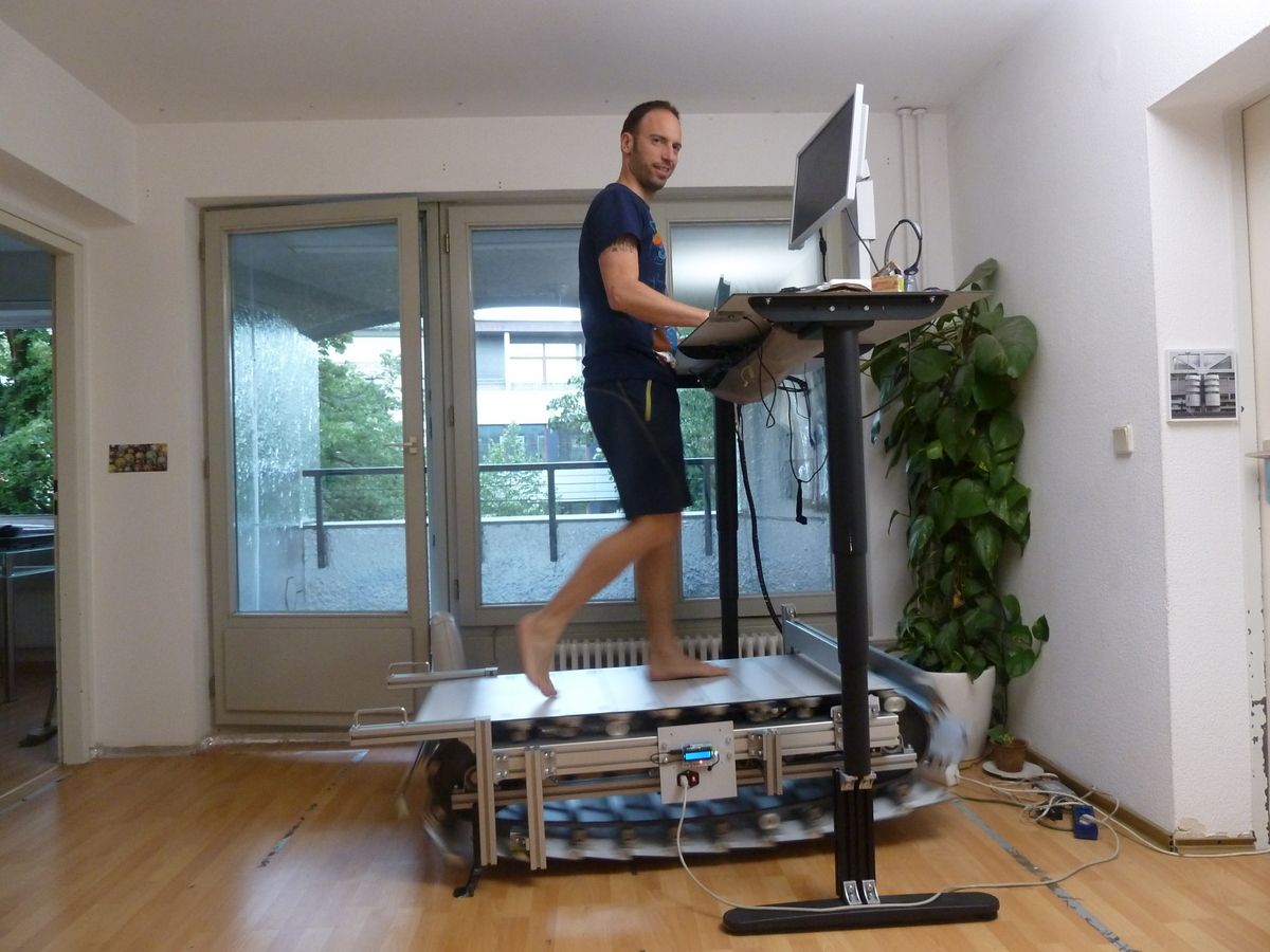

Squ1sher
Squ1sher
3 years ago
Now i finished the successor project (i'm using it but it is still a lot work in progress). If people are interested, i can make an instrucables page for it.
Greetings from the walking side !

Robb
Robb
Reply 3 years ago
Wow! That looks amazing! What does it do that a ordinary treadmill doesn't? Is the speed automatic?
0
Squ1sher
Squ1sher
Reply 3 years ago
It's a different principle. Usual gym (and office-) treadmills (belt-based) killed my calves after hours of walking on it, because of the stop-effect (friction between belt and desk on every foot-impact slow down the belt a little bit). So this one uses slats (24) with small wheels. -> super nice to my calves now. I still have to improve it to get rid of vibrations (thats where hamster wheel shines ;) )

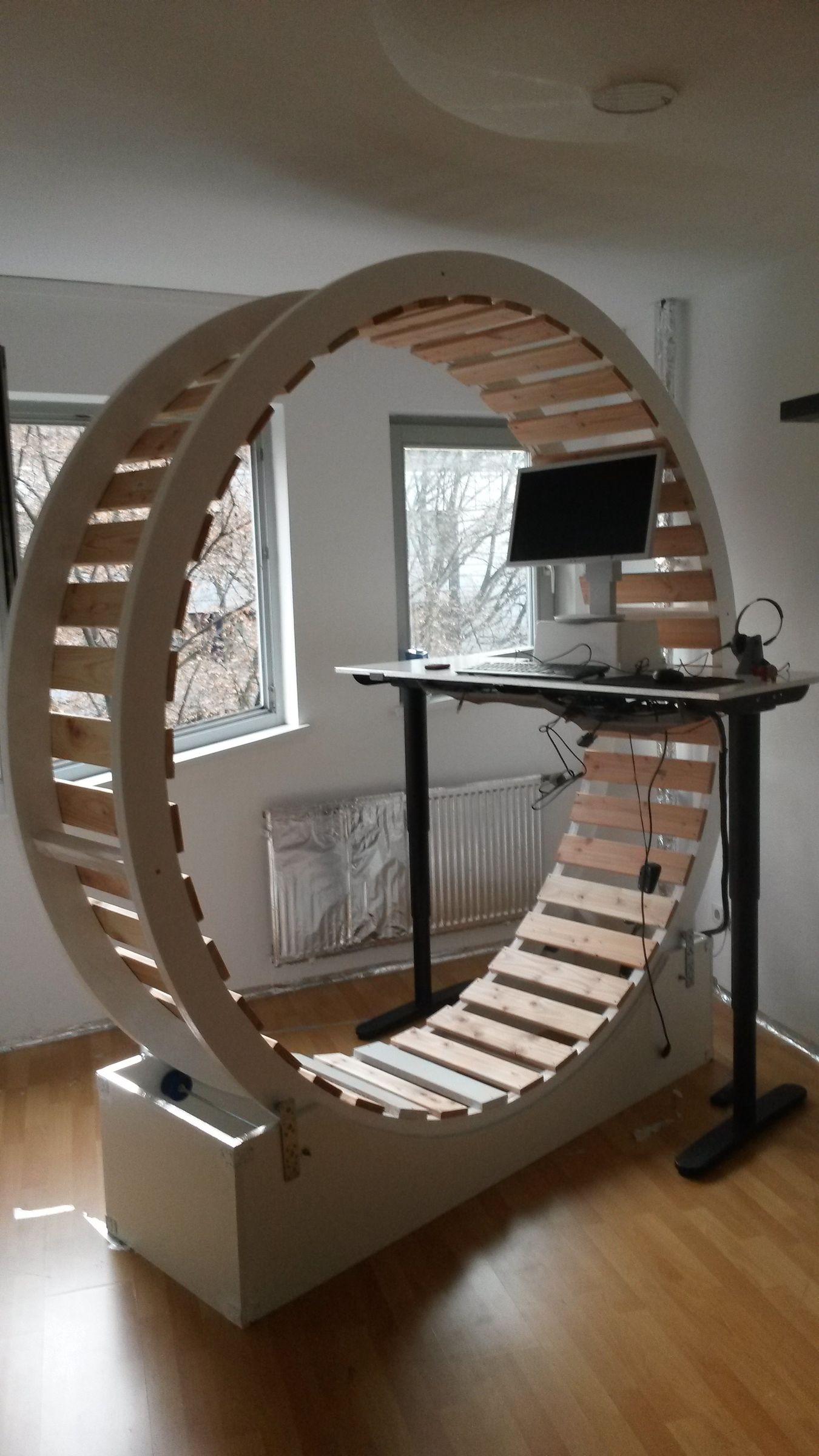

SebastianG152
SebastianG152
3 years ago

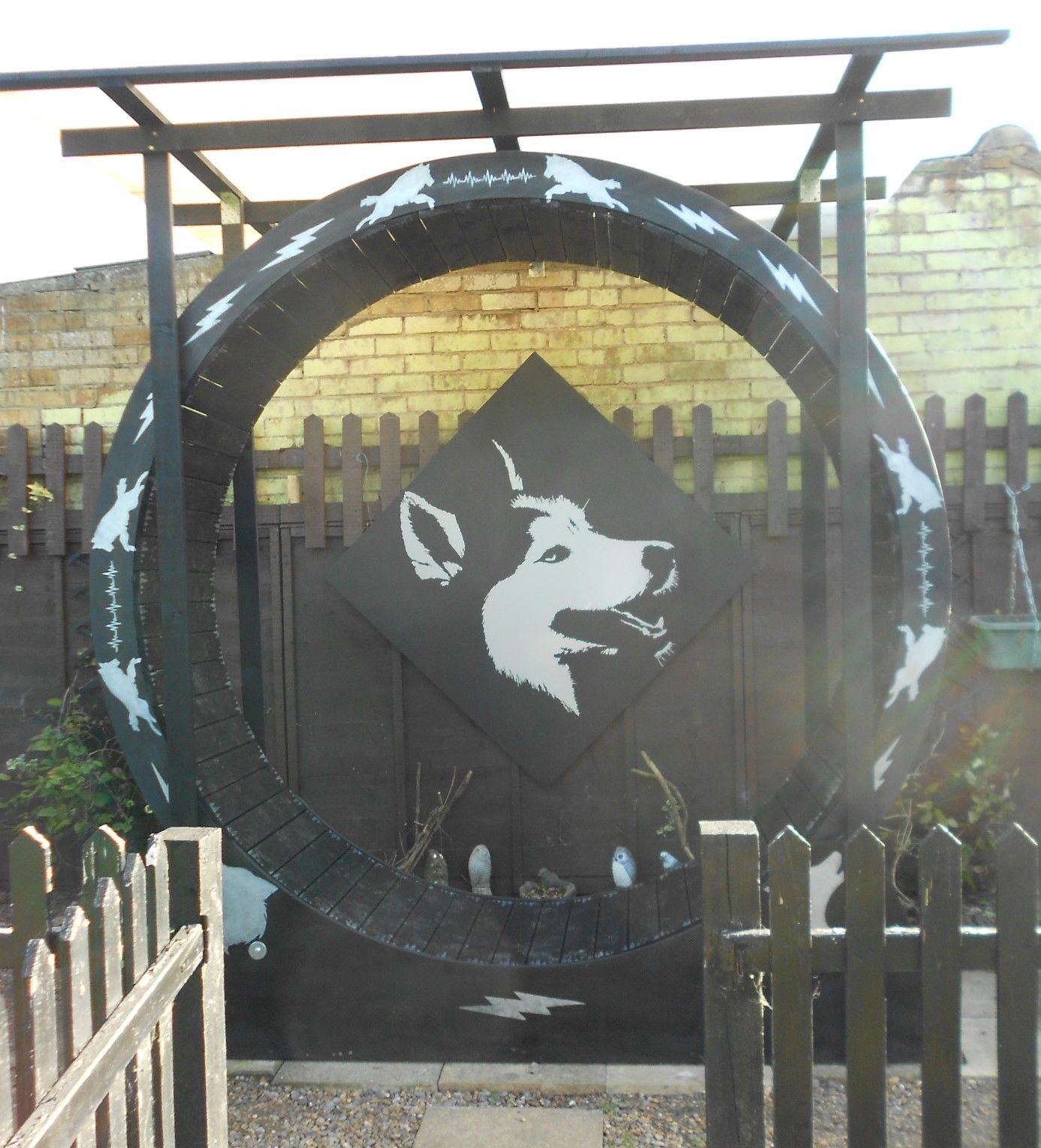

Hello Robb, nice idea and instructions!
A year ago, I wanted to change something to get rid of my old desk and
have some more motion while working in my office. First, I wanted to have a
walking/standing desk, but the sound of treadmills was too loud for me.
I thought that a big human-hamster-wheel would be nice solution and
after some searching on the internet I found your instructions for your
hamster-wheel!
I decided to design and built a wheel made out of metal and a new
customized standing desk. Almost one year later I'm standing in my wheel and
got rid of my chair.
The Inner diameter is 2,30m and the width is 1m. You can find more details on my homepage: https://www.glanzner-dynamics.de/en/das-work-and-go-projekt
