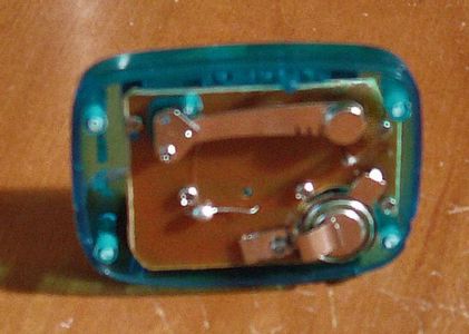

I took off the back cover and had a look at the mechanism. Ah-hah, that's how it works! Basically, there's this little rotator arm held suspended above a contact lead by a spring. When the gadget is motionless, the arm is in equilibrium, and the circuit is open. If you jerk it a little (as would happen when you took a step), the arm swings down briefly and touches the lead, thereby closing the circuit. It then swings back up again, and after oscillating slightly, is once again held poised above the contact by its spring. Ridiculously simple, really.
All I'd have to do is have the wheel move the arm on each revolution, and I can count how many times it spins!
Please forgive the blurry pics here -- the pedometer is quite small, and this is the best macro photography my camera can muster. I tried to outline the important parts...

My first thought was to attach a rare-earth magnet to the wheel, and move the pedometer arm without even touching it. I grabbed a little magnet and tried it out. Nope -- the arm isn't nearly magnetic enough to pull this off. Of course, I could hang one magnet on the arm, and another on the wheel... but no, that would make the arm weigh too much and throw off the balance created by the spring! Looks like I'll need a mechanical trigger.
But wait, the pedometer only counts when its arm swings down. That will work just fine for counting clockwise revolutions, but what if my hamster gets confused about where Mongolia is, and gets the wheel spinning counterclockwise? I can't hold poor sense of direction against her, after dispensing with the oceans and mountains!
Solution: solder a wire to the peg, creating another point of contact for when the arm swings upward from its equilibrium position. Done!
