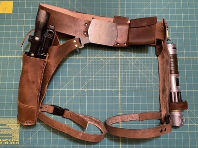

We are working on our Galactic Starcruiser personas and costumes and one of the core components is the belt! This is a brief run-through of a buckle and belt making technique that can be done with some basic leather making tools, a jig saw, and either a wire-feed welder or drill for a bolt-through option.

Step 1: Cut the steel bar stock to the shape you want, make sure that the buckle can be hidden behind the plate, so don't cut off too much! You can use a jig saw with a metal blade for curved and straight cuts, or a metal bandsaw for angled/straight cuts.
Step 2: Use the jig saw to cut out the metal divider on the cobra buckle and feed your leather strap through so you can lay out your pieces.
Step 3: Lay out the buckle and the studs with the buckle and mark where you'll be welding them so the cap bolts will secure the buckle to the plate.
Step 4: Weld the studs onto the plate and grind down the excess slag. Alternatively, you can drill through the plate and use a through-bolt attachment, but you'll have two bolt heads on the outside of the buckle plate.
Step 5: Fit the leather strap through, measure and punch holes for two Chicago screws on either side, leave a tail to punch new holes if you grow or want to put the belt over larger costumes/armor.
Step 6: Take everything apart, dye your leather and finish it, then reassemble your belt and start work on your pouches/accessories!
