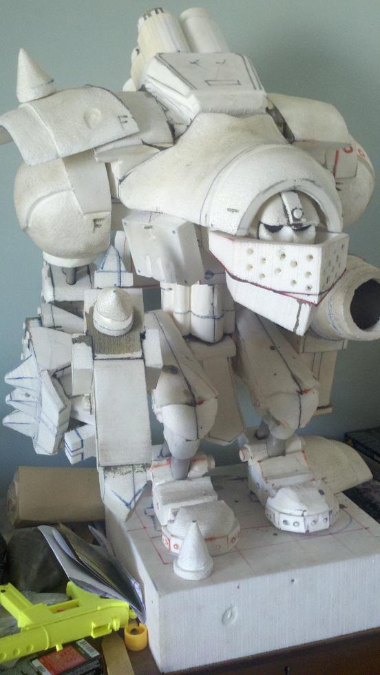

Once you've mastered properly rounding an edge you can accomplish a lot more then you think. Like the fellow below.
As much as I love the art of making everything by hand, if I need more then one basic shape that my medium doesn't come in, its a real time consuming pain. Like the pretty little robot. If I win this CNC I'll get more done quicker......and probably more accurate, almost machine like accurate :-)
Hes a Destroyer from War Machine - my 2ft version scaled up model from his 2in table top original as a concept model for a larger life size version that never got approved. So its an up scale for an up scale!
