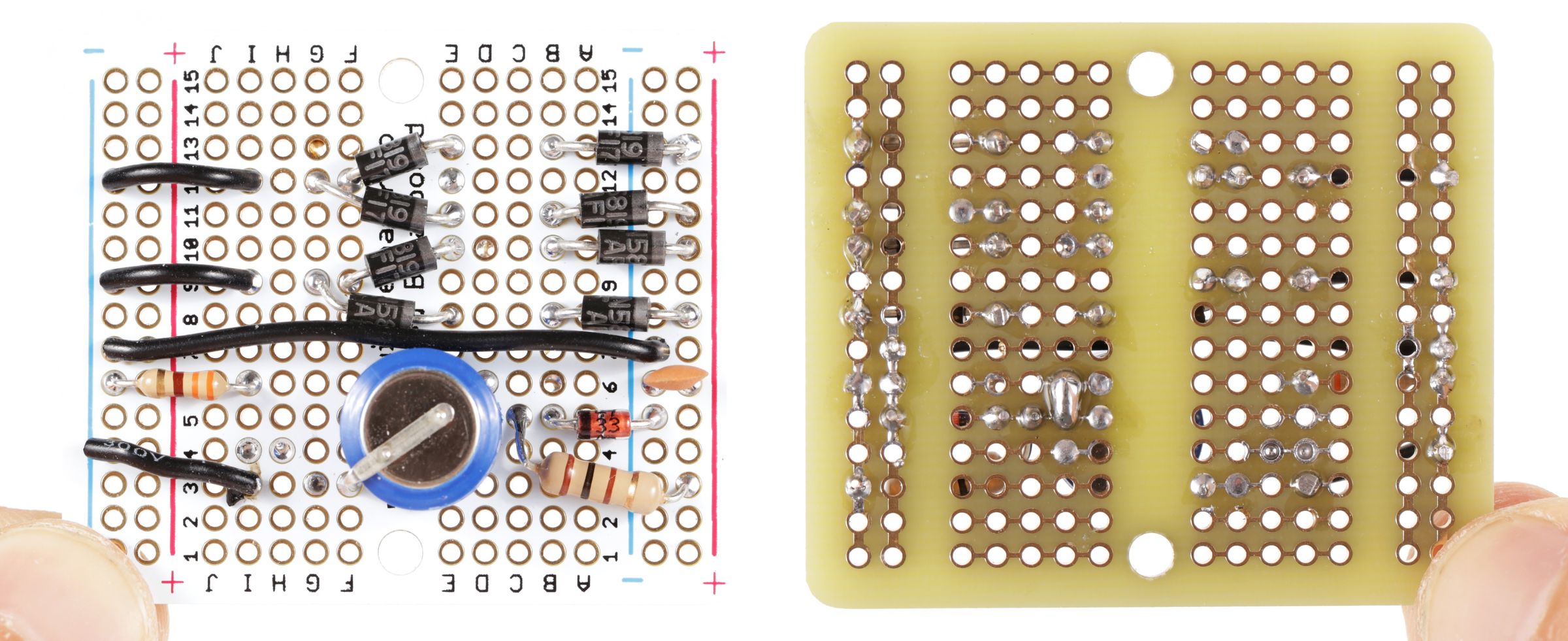

Step 17: Wire the Circuit
Now is time to build the circuit on the PCB as pictured in the schematic.

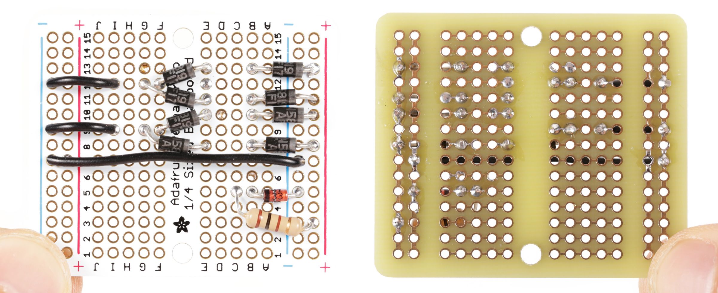

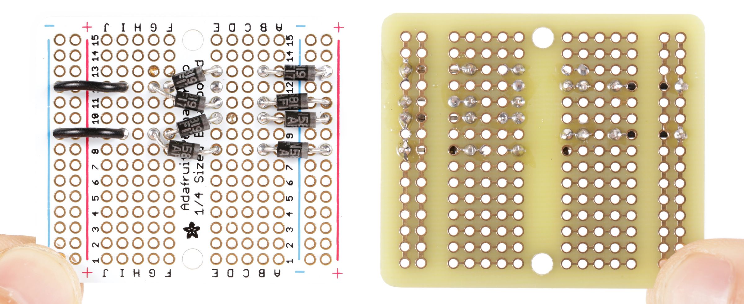

To begin, I wired the two bridge rectifiers in place.
I then connected the zener diode voltage regulator.

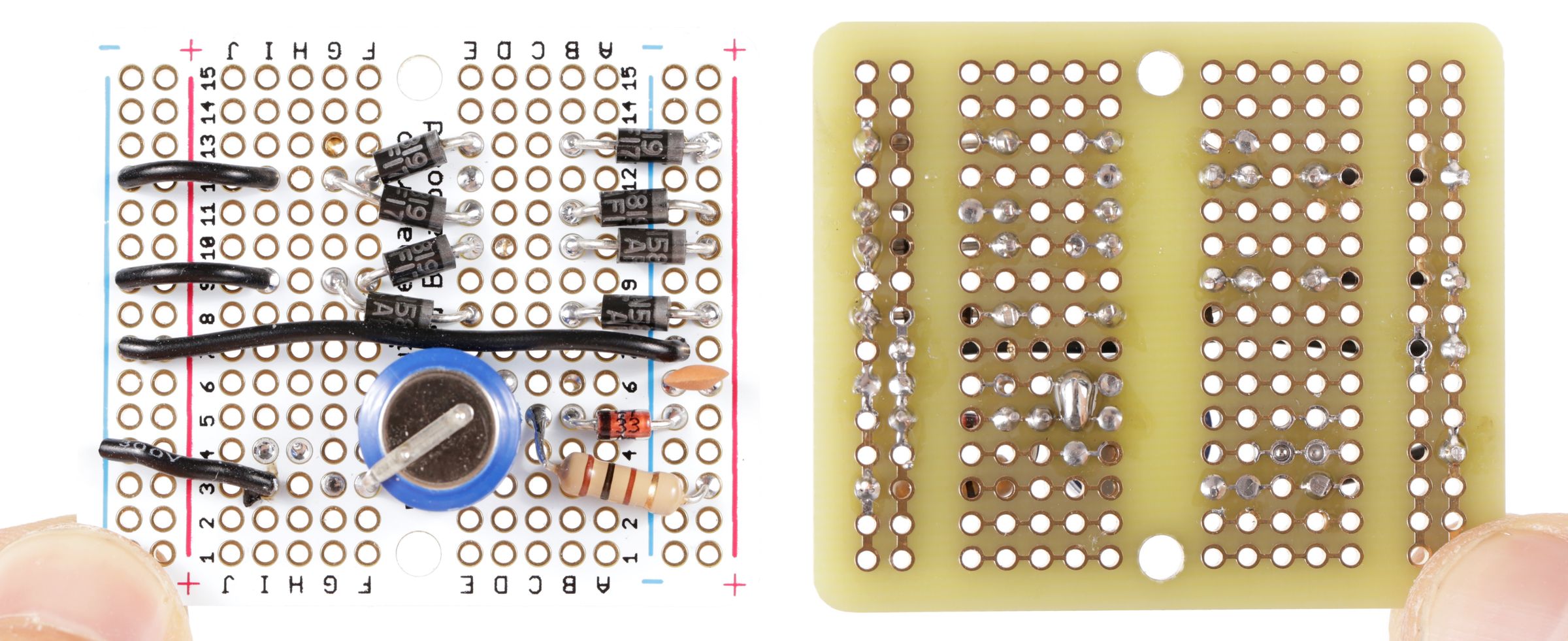

After that, I wired in both capacitors.
Lastly, I added the resistor for the LED. The remaining components will be mounted off the board and connected later.
