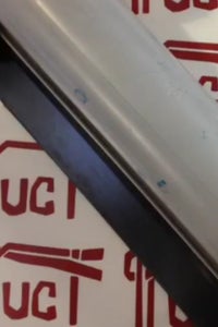

Step 4: Example of a Poor Location for Vinyl Decal Application
When selecting a place to apply the decal make sure that it will stick well I use a sample piece of vinyl to test locations for adhesion. This location attempting to apply a vinyl SFlettering decal to the outside of an easel did not stick.
