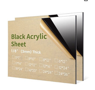

Hard plastic sheet: I started with CD cases. For better contrast and visibility, I used a CD case with a black bottom and a clear lid. This video was made earlier as a proof of concept using a CD case. It's hard to see on the phone camera, but you can see an image moving back and forth across the CD case. However, a black acrylic sheet provides the best results and this is what I use in this Instructable.

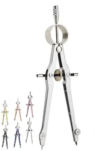

Compass: For more precise scratches, use a compass with a center control wheel, which helps prevent the legs from shifting during use.

Set the compass points to a fixed distance—this will determine how far in front of or behind the surface the resulting image will appear. Place one point of the compass on a dot from your pattern on the plastic sheet, and gently rotate the compass to create a scratch of full circle.
Be careful: you want to leave a visible, smooth mark without digging too deeply or producing white, dusty scrapes. The scratch should catch the light but remain clean and subtle. When you tilt the sheet under sunlight, you should see a bright point of light traveling along the arc—this is the key visual effect of a scratch hologram.
