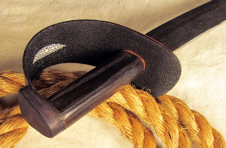

Step 5: Cup Guard, Handle, and Copper Kraken
Here the cup guard has been fitted with an ostrich leg skin overlay and leather bolster on top, and stingray skin on the inside.
The oak handle has been torch scorched and stabilized under a vacuum with wood hardener. I use two part marine grade epoxy putty to fit the tang hole perfectly to the tang.
The hilt assembly is then temporarily assembled for fitting and adjustments.
In the last picture there is a copper fitting depicting a deeply etched kraken. I used a masking process and ferric chloride soak to make it.

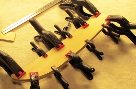

Step 6: Wooden Scabbard
This is fairly self explanatory. I cut the 1/4" poplar on a band saw, used wood glue, and clamped it up.

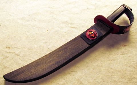

Step 8: The Eye of the Kraken
Here the scabbard has been sanded and stained.
This kraken eye was made by mounting a glass cabochon on a printed eye graphic, mounting that on leather, and covering it with an ostrich leg skin eyelid.
