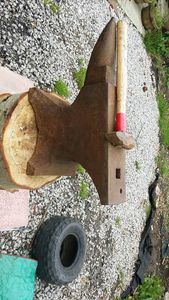

Anvil
Let's Kick this of with the widely Recognized Anvil, you will Need something with a Hard Surface to Hit-on.

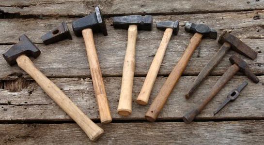

Hammer
You need something to Hit the Hot Steel with to Move it to Shape!

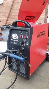

Welder
Now their is Various Welding Processes you can use. For me i used My Mac MIG Welder i'm Fortunate enough to have, but you can use MMA (Stick) & TIG also, but if you have no Welder, don't let that be an off put, you can use Oxy-Acelaline or just use the Hot-Peening Method, for Attaching the Leaves i'm not to sure, maybe some REALLY Strong Epoxy of some sort, i'm not all clued up on this, as i just weld them on so i'm not all that sure!

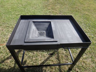

The Forge
You can go as Fancy or as Poor-Man as you like on the Forge, from Coal to Charcoal to Gasses like Propane & Acetylene, the choice is Your's, as long as it is suitable for the Project in Hand & Heats the Area your Hammering on well. You have yourself a Forge. Just don't go Killing yourself & doing something Stupid like Blowing up the Neighbor's Cat you may Laugh, but i'm sure they Won't!!

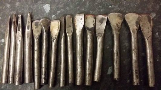

Forging/Metal Working Chisels
For Making Mark's in the Steel or Leaves or what not, you are going to need something with an Edge that can stand the Impact of Carving Steel. I would recommend Making or Buying a few different Size Chisel's. Always come in Handy!

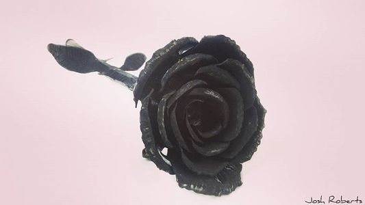

Petals
Cutting & Shaping the Petals is easy, but Shaping them on the other Hand is Not! i know this might Sound a little Sour, but if you ever make them you will realize, it is an Art form, but like any Piece, it is a Jigsaw you have to slowly Mold to Perfection! It is Tricky but with Practice & many Failed attempt's you will Latch on to it, just figure out how you will Curve the Petal, where it will go & how much bend you want to it.

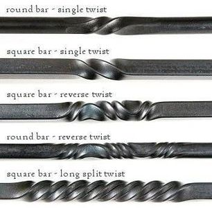

Twisting the Stem
We all want to add abit more Fascination into our Pieces! So we decided to give this Plain Round bar Stem a Little more Life with a Reverse-Twist!, Yet again, it's about getting up to the Forge & Practicing, but i think it gives a lovely affect to the Work, just a shame it slightly cover's the Twist with Spray Paint.
