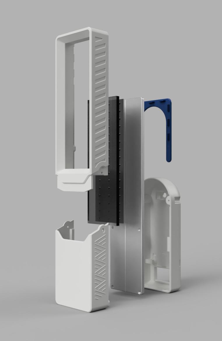

Step 3: Design
The constrains for the design are to be able to hold it with one hand, easy assembly and also my favorite "Goooood looking" :)
I am much more confident designing for 3D printing than any other processes. I have designed mostly for 3D printing for that reason. However, there was need for other methods like laser cut plexi-glass and aluminum cutting and drilling.

I'm using 2x aluminum side by side which are 30 mm x 5 mm x 261 mm. The reason that I'm using these is because I have the material and did not wanted to purchase another one. You can use whatever you have to use as a back plate. Using metal is suggested since these LEDs are getting hot, however, printing them would work either. Just try not to let them heat up that much. The locations to drill on the aluminum given with a PDF file to print out on a paper and use as a template.
Plexi-Glass Cutting
This is a cut that you can do with hand tools or woodworking tools if you have. But I prefer to make it by laser cut. Here's a vector file for that.

First of all, let's attach the LEDs. To do that, place the aluminum block on the back of the 3D printed LED section. Use the cable openings on the printed part to align LEDs, and stick them to the aluminum. Now we have to put the plexiglass. Remove the aluminum along with LEDs, put the plexiglass in and place the aluminum again. The inside can be covered with aluminum tape to bounce more light and prevent PLA to show the light. If you want that, do it before putting plexi and aluminum back. The only part to be glued can be attached now permanently. I used CA glue which works perfectly on PLA. Place one or two drops onto each fingers touching side and attach them permanently. Don't worry! The aluminum block still can be removed. Once you get the cables of LEDs to the other side of the aluminum with the holes right next to them, this assembly will be finished and set aside for now.
Now, it's time to place batteries. The battery holder should fit easily into the battery compartment of the model. I used hot glue to attach the holder to the PLA but double sided tape would work just as fine. In this part of the model, there is also a hole for tripod mount. I used square nuts for the purpose. It would work the best if you can find them. Regular nuts could be embedded with some help of a glue or something.
These two assemblies are designed to slides onto each other and screwed from the side. Do that, and we are halfway there.
The BMS now should be attached with double-sided tape making sure that it's not going to touch to the aluminum.
The last thing before closing it up is to put the electronics in. Most of the electronics have specified places on the model. I would like to start with the battery indicator. Put it in and glue it up with hot glue. After that the button can be placed after soldering two cables to its legs and again hot glued. The battery charger, the voltage regulator, and the dimmer are just the same. Use hot glue to attach them to their places as seen in photos. Rotational part of the dimmer is going to be screwed from the outside. The nut to do that comes within the package.
