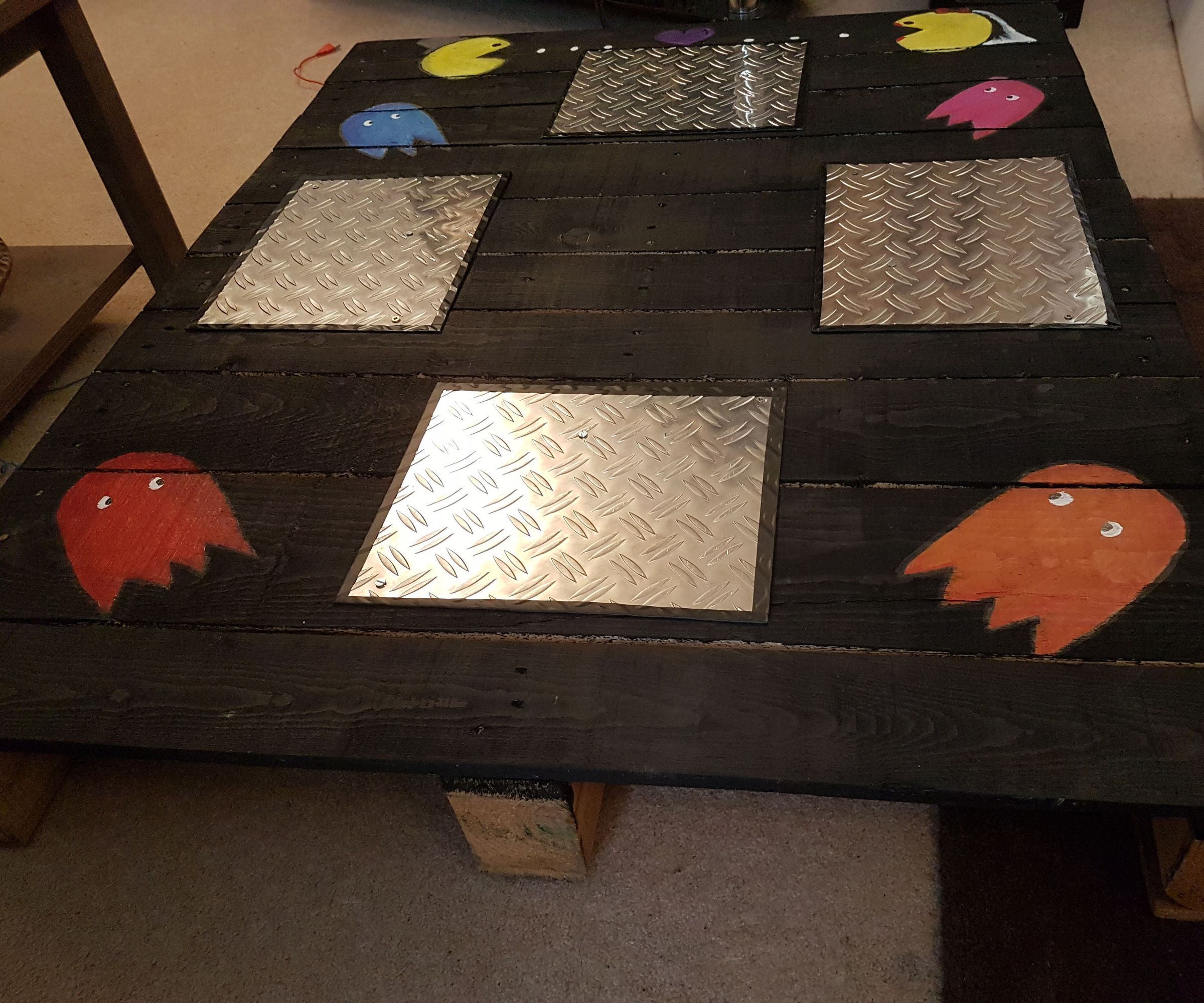

Step 3: Paint Your Panels
We decided the best panels to paint would be those that are on show to the players all the time. These are the 2 Side Panels & the Button Panel.
We went for mostly space themed game designs, such as classics like 'Asteroids' & 'Space Invaders' See the Photos. These were painted freehand by my very talented other half. Be sure to use a ruler to do a pencil outline of your designs, especially the blocky characters, such as the Space Invader Aliens.
If you want to add a star background to your panels, carefully flick white paint off your Fine brush onto the black Panel.
