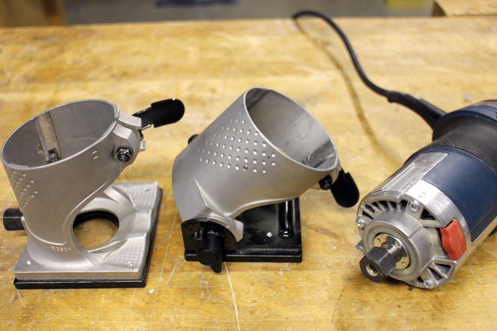

Flat fixed or tilting base
All hand routers (palm and plunge) will come with a base that fits onto the router body and will have a base that is perpendicular to the router bit. There's an option to have a removable router base that can be tilted, meaning you have have your router bit placed at an angle to the piece you are working on. The angle of the tilting router base can be set with a thumb screw on the side, which will also have an angle indicator so you can set it to the correct degrees.

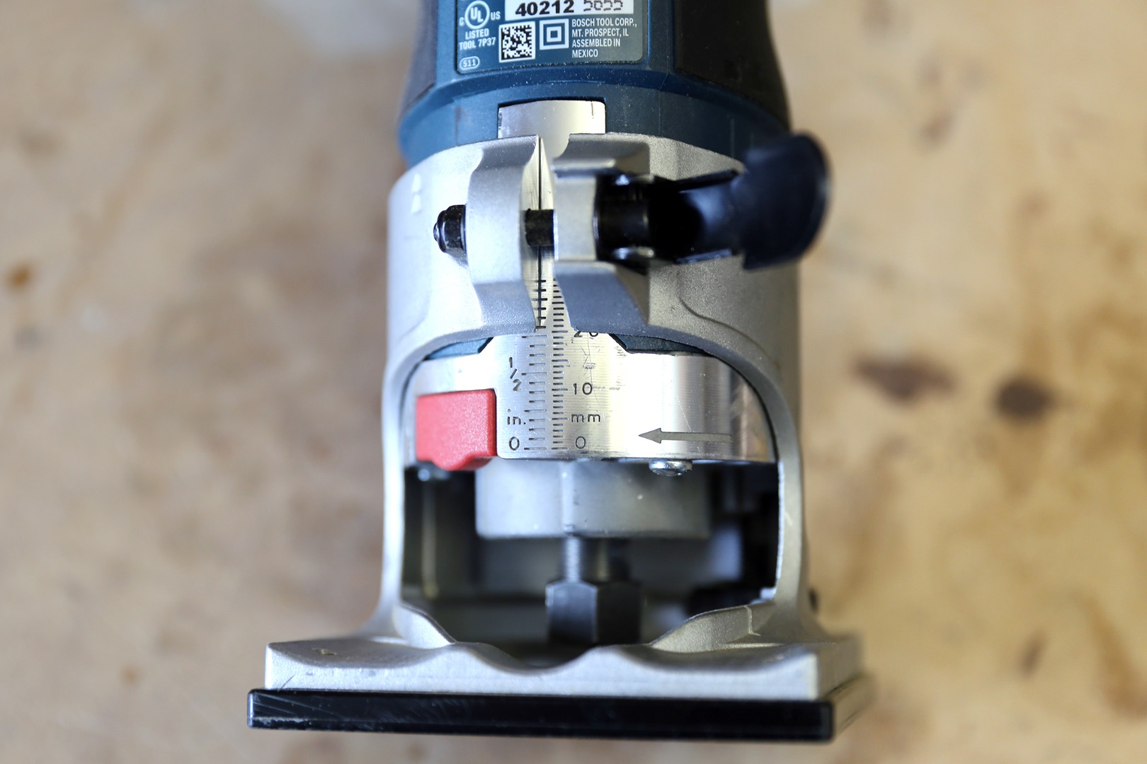

Bit depth
Some routers have a plunge feature, which allows the router to be dipped into the work piece and will spring back to a preset distance. This simple router doesn't have a plunge feature but does allow you to set your bit depth by unbuckling the hasp and setting the depth of the fixed base.
The measurement notches are measured from the collet and are meant to be an estimate, since the height of the collet can vary slightly based on how tight your bit is screwed in, and how much of your router bit shank is revealed.

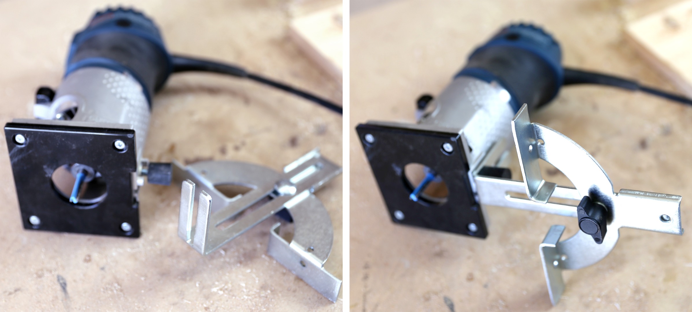

Router Attachment - Edge Guide
Some routers come with attachments that serve a function to help you with your work, such as a straight edge guide. Edge guides are able to be attached to the router base by a hand screw and will allow you to set the distance of the guide to act as a fence.
The edge guide travels over your work piece and along a straight edge, this will guide the router bit to trim a straight edge on the opposite side of the work. Either measure the distance from the edge of the router bit to the inside edge of the fence, or set the fence distance by hand by placing the fence over the piece you wish to cut. The fence distance can be set with a thumb screw.

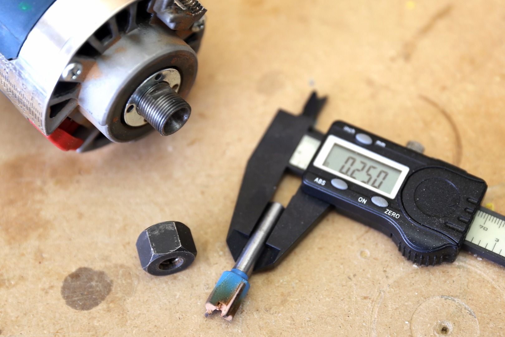

Shank Size
The shank of the router bits that fit into the collet are usually in either 1/4" or 1/2", so know the size of your collet before buying a router bit (or buy a secondary collet so you can switch).

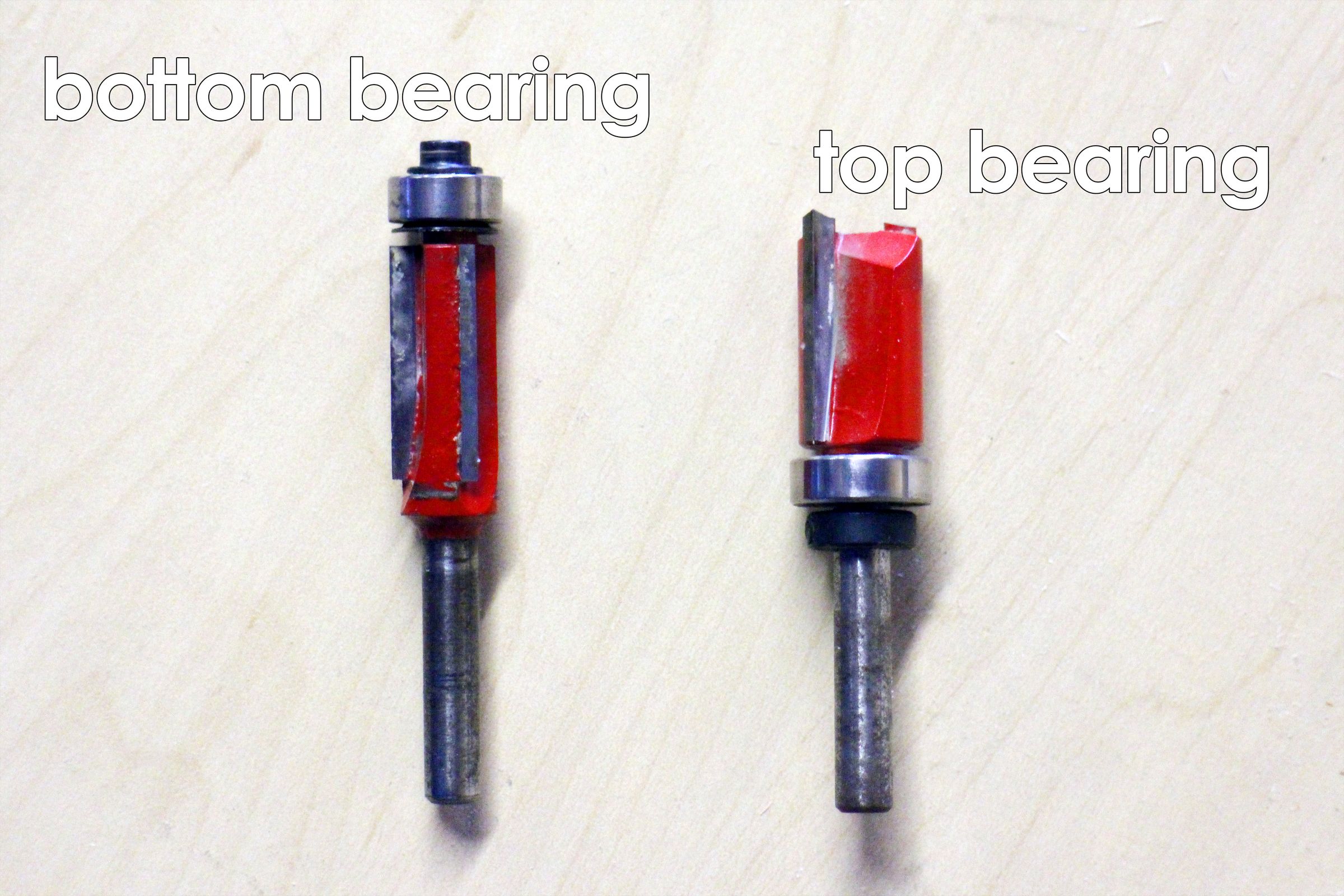

Top vs Bottom Bearing
Some router bits have a steel bearing on the axis, this bearing allows the bit to ride up along your work and use it as a reference.
The bearing can be located at the top of the bit, close to the router body, or bottom which will ride against a smooth surface and trim everything between the bearing and the shank. With the bit inserted into the router and held in your hand, the bottom bearing is at the bottom, and the top bearing is at the top.

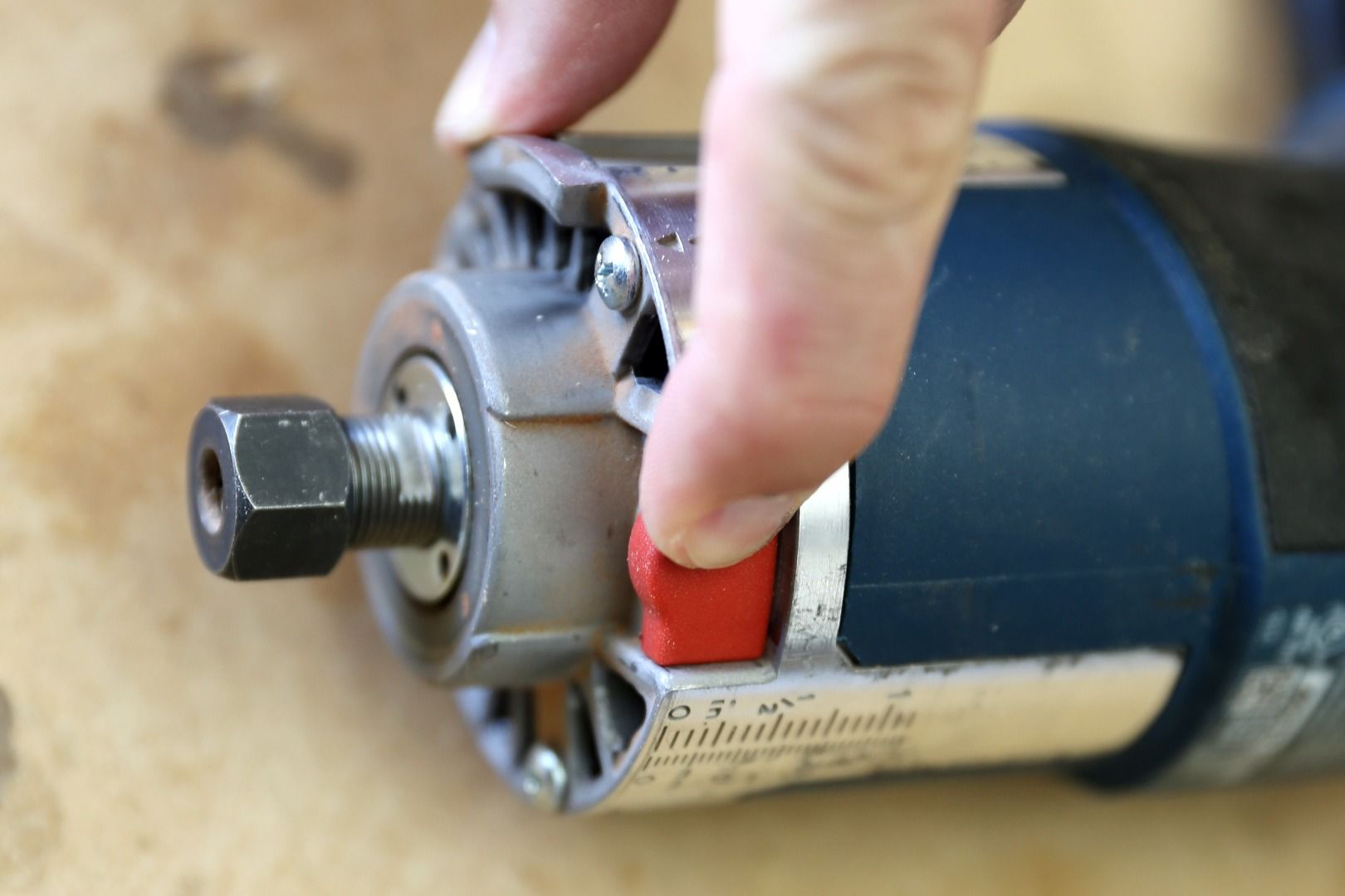

Routers have a threaded neck that the collet and nut fit onto, the way the bits are are inserted the unit will tighten onto the bot when it's spinning. Changing router bits is easy, but should only be attempted when the router is unplugged.
If you look below the nut you can see a keyway on the threaded neck that a wrench can be fitted into, with a wrench on the top nut you can hole the threaded neck and turn the nut counterclockwise to undo and remove the nut and collet.
Some routers have a momentary lock on the side which locks the threaded neck in place, eliminating a wrench needed for the threaded neck.
The lock button needs to be held in to engage the lock, and will disengage when released. The lock will only fully press into the router when the threaded neck is in a particular part if the rotation, so the threaded neck may need to be rotated slightly for the lock to engage.
When tightening the nut only use enough force to snugly hold the router bit, overtightening will make the bit very difficult to remove later.

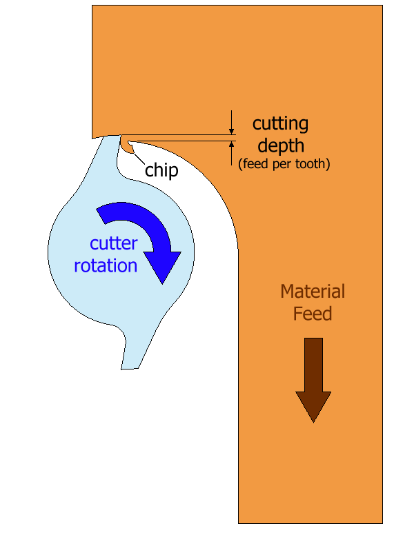

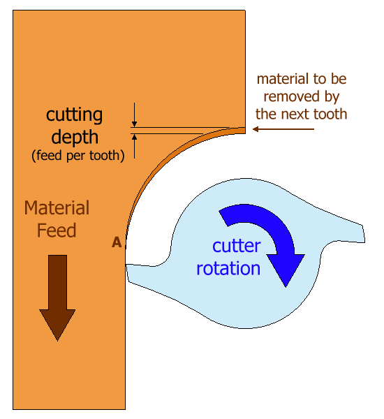

A milling cutter can cut in two directions, sometimes known as conventional (or up) and climb (or down). For almost all cutting with a palm router a conventional cut is recommended, but know that it can cause tear out when reaching the end of a cut.
Conventional cut
Climb cut
Conventional milling (left): The chip thickness starts at zero thickness, and increases up to the maximum. The cut is so light at the beginning that the tool does not cut, but slides across the surface of the material, until sufficient pressure is built up and the tooth suddenly bites and begins to cut. This deforms the material (at point A on the diagram, left), work hardening it, and dulling the tool. The sliding and biting behaviour leaves a poor finish on the material.
Climb milling (right): Each tooth engages the material at a definite point, and the width of the cut starts at the maximum and decreases to zero. The chips are disposed behind the cutter, leading to easier swarf removal. The tooth does not rub on the material, and so tool life may be longer. However, climb milling can apply larger loads to the machine, and so is not recommended for older milling machines, or machines which are not in good condition. This type of milling is used predominantly on mills with a backlash eliminator. [source]
For hand routing, it's advised to only use conventional milling, this will prevent grabbing and kickback.

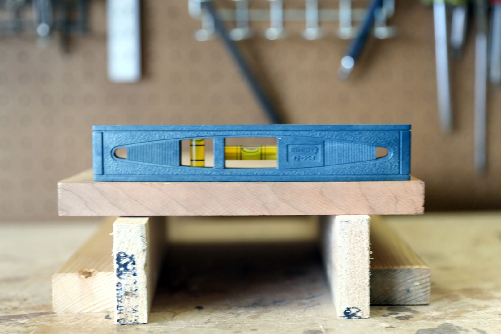

The router will need a flat reference to glide across in order to surface plane. Setting up a temporary fence or rail is a great way to quickly get a flat reference that can be taken down or modified for future planing operations.
Find flat sections of wood to make 2 rails that will be used as the reference rails for the router to glide on.
With 2 rails we can attach them to the workbench and use them to plane down the glue up to a uniform height.
With both rails set up on your workbech a plank can be laid across the top of the rails to check if they are level. If there's any discrepancy check the workbench for levelness first, then check the rails to ensure they are symmetrical.
Having level rails means that when the router is riding on top the router bit will carve a level surface.
