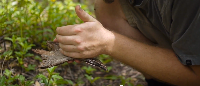

Start by stripping all the bark off into a pile. Keep the bark, it's good tinder for later.
With the bark stripped off, sight down the stick and cut off the end that is most bowed. In my case it was the base of the stick which was good because this off-cut is used to make the hearth board later on.
Next, jam your stick somewhere where the outside can dry off a little, while you collect other things and make the hearth board. I used two small sapplings and a stick to force the bow of the spindle out. While the outside cures, it will help keep the spindle straight.

Believe me when I say this is where I have seen many people come unstuck. The coal is an important step because the hard work is done and now patience is required.
Blowing your coal straight up will soon put it out. Try to use your knife to pile the unburnt drill dust on top of the coal. A slight breeze is enough to keep it growing. You can also shave dust off the spindle and add it on top of the coal. Keep adding dust till it's of a decent size - about 12mm or half inch is ample.
Step 9: Coal to Fire!!
When the coal is large enough, use your knife to carefully scrape it off into the nest center. Take the nest to the location you want to light the fire and begin by carefully folding the nest on itself. With a swinging action re-boost the coal in the center. This is a gentle way of ensuring the coal's survival. Next, hold the nest above your eyes with the wind blowing away from you and blow into the nest. Keep blowing. The smoke will pour out and eventually burst into flame. Squeezing the nest gently will aid this process.
