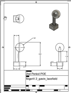

Step 5: The Hand
  1. 3D print 3 Hirth Joints
  2. Place the springs inside of the hirth joints going all the way through both pieces, the more through the other side the better
  3. Hot glue the screw to the knob, then hot glue the spring around the screw
  4. 3D print 3 “fingers”
  5. You can slide these into the large square holes protruding from the Hirth joints
  6. Slide fingers into one half of the hirth joint if necessary use hot glue to keep it n place but the “finger” should be pretty stable
  7. Hot glue the 3 ft. of flexible plastic tubing to the 3.8 in Styrofoam ball
  8. Mark the other side of the Styrofoam ball and measure 1 in out in 3 directions from that point on the ball and mark this location this is where the fingers will go, that point is where the front of the finger will go
  9. Next sketch out the square into the Styrofoam ball and begin to dig slightly in that shape just to lower the overall height of the finger do this for about 1 cm or 2
  10. Hot Glue the finger hirth joint combinations into those spots make sure to have the sphere of the finger facing towards the midpoint
