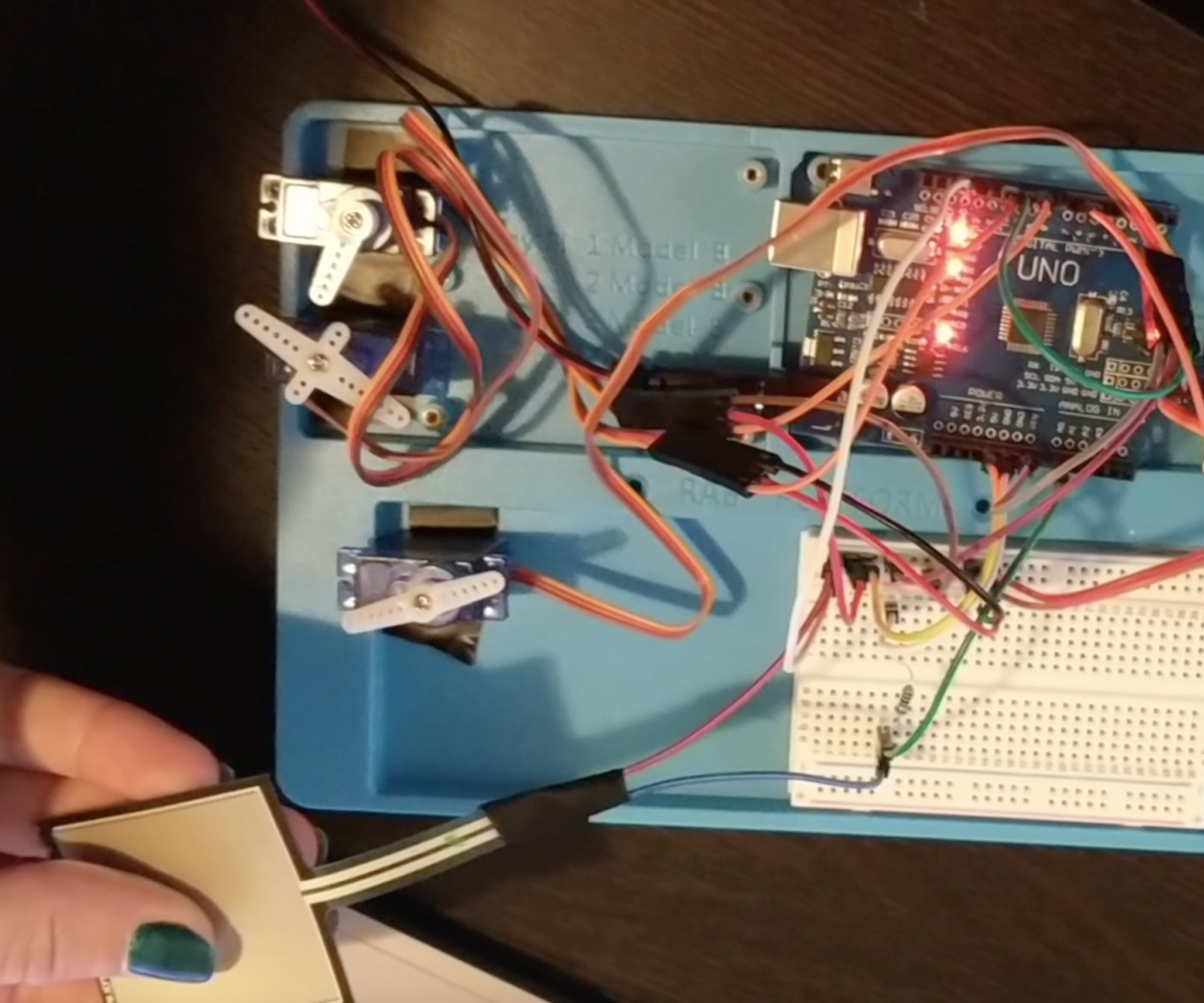

Step 2: Sensor Set-Up
First, you will want to test your sensors to be sure that they work properly. After confirming that the proximity sensor is working correctly with the code that comes with it, you may begin breadboarding. Once you've included the vibration motor you will be able to use the code shown here to use your sensor with the motor.
Step 3: Begin Assembly
Transferring the breadboarded example to the shield is fairly simple just be sure to pay attention to where your pins are, especially with the logic level converter. After you've completed the transfer go ahead and test it all again to be sure that it works. Now you can begin making a pocket to hold your components to the glove. Velcro is your friend! This will save you a lot of time, and it's a material that allows you to put things together while wearing them. Wearing the glove while assembling it is a good idea because you will get more accurate placement for your components. This is the part where you can get creative and decide how you want your piece to look!
