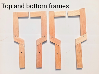

Step 2: Making the Frames
I took a couple of popsicle sticks and with my ruler and pencil, I drew the shapes I'd cut out of it. For the sake of simplicity, I've made a template for the pieces needed and attached it to this step so you can easily cut out the pieces without much worry about measurements.
To cut the pieces, I used a hand saw. First position the hand saw on the line you want to cut along and gently pass it along to and fro until it makes a groove and then follow through till the saw cuts entirely through. It's very quick and does a neat job.
Each frame has seven pieces; arrange and glue them as shown in the pictures, three pieces below and four pieces on top; this way, it has more rigidity to it. When glueing the pieces for the left-hand side make sure to flip them over.
I made four of these frames. Two (right and left) for the bottom and two (right and left) for the top.

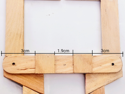

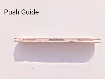

Step 3: Making the Push Guide
Attached to this step is the template for cutting the pieces needed to make the push guide. Two long pieces with curved ends (one of the ends was normally curved, but the other end was sanded by me, it has more aesthetics that way).
I made two holes each 1cm away from the ends of each piece.

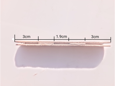

Then I cut two smaller squares of sides 1.8cm (which is also the width of the popsicle sticks I'm using).
To assemble the guide, I glued the two smaller square pieces on one of the long pieces 1.9cm apart and 3cm away from the ends.
Then I glued the other long piece on top of it, making sure the holes of the two pieces aligned. I left it to dry.

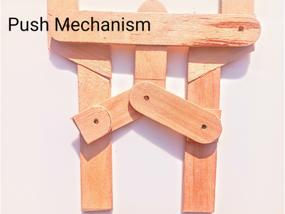

Step 4: Making the Push Mechanism
The push mechanism primarily consists of two inclined arms that come from the handles and hold onto the push rod, which goes through the push guide.
Attached to this step is the template to cut the pieces needed for this step.
I cut the two arms out and sanded the ends to be curved, I bored holes into the two ends of each piece as I had marked in the template.
For the push rod, I've also included it in the template and the mark for its hole.
To arrange the pieces, one of the two arms goes under the push rod and at its base, two smaller pieces are arranged on top of it to accommodate the space between it and the top frame, the second arm goes above the push rod and at its base likewise, two smaller square pieces are arranged under it to accommodate the space between it and the bottom frame.
The push rod is inserted into the push guide and the pieces are fastened together and to the bottom frame through the holes on them with cut bamboo skewers.

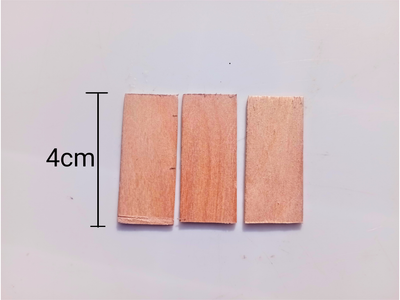

Step 5: Filling the Gap Between the Top and Bottom Frames
As shown in the pictures, I have attached the top frame temporarily to the structure made so far and the gap between the top and bottom frame created by the presence of the push guide and push mechanism is obvious and needs to be filled while also making sure that movement of the push mechanism is not hampered.

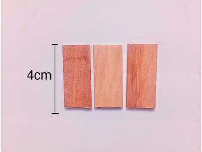

For the gaps within the handles, I cut three pieces, each of length 4cm for each of the handles. The three pieces were glued on top of each other and then onto the bottom frame; the same was done for the other handle.

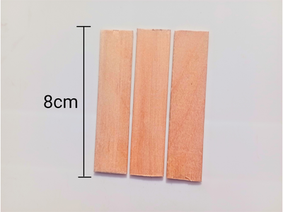

For the mouth part of the tool, for each side, I cut three pieces, each of length 8cm, glued on top of the other and onto the bottom frame. For the front-facing part of each side, three pieces each of length 4cm, also glued on the other and to the bottom frame.
In the case of any protrusion or one part being longer than the other, I made use of the saw and afterwards sanded the cut surface.

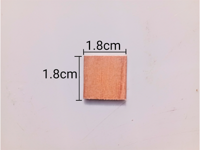

Additionally, I cut two 1.8cm square pieces made a hole at the centre of each and used them as stoppers to secure the central point of motion of the three parts of the push mechanism. After inserting the square pieces through the skewer, I applied super glue to bind them to the skewer while making sure the push mechanism rotates freely within the two stoppers.

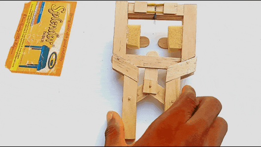

At this stage, we have made good progress, and holding the egg breaker by the handle and pressing it together pushes the push rod forward and opens the mouth wide apart (and that's it, nothing else). It should be able to sort of retract on its own and push the push rod back while the mouth closes; for this purpose, we will be making hooks for an elastic band on each side of the tool's mouth.

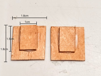

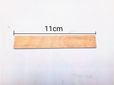

For this, I again cut two square pieces 1.8cm by 1.8cm in dimension and two smaller rectangular pieces 1.5cm by 1cm in dimension. I glued the smaller rectangles on the bigger squares at the midline towards one end as shown in the pictures. After the two pieces had dried, I then glued each of them to one side of the front-facing portion of the mouth at 3cm apart.

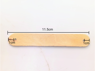

Flipping the egg breaker over, I cut a piece of popsicle 11cm in length and glued half of it to one side of the front-facing portion of the tool. This is to prevent one side of the egg breaker from dropping below the other as a result of unequal bearing of the weight of the egg.

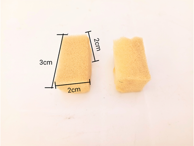

Next, I cut two pieces of foam and glued (a generous layer of wood glue) each on one side inside the mouth of the egg breaker. Each piece of foam was 3cm long, 2cm tall, and 2cm thick.

I left the egg breaker for about 24 hours for all the glued parts to dry hard, and after that, I cleaned all the rough edges with sandpaper and sawed all parts to be equal. Then I tested the mechanism by repeatedly opening the mouth while the elastic band kept closing it back.

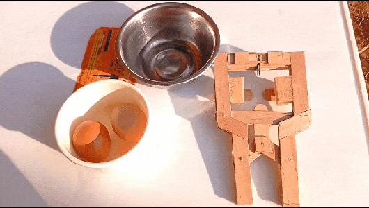

Step 9: Usage and Conclusion
It worked fine!
As shown in the first gif image, take the egg and position it centrally in the mouth of the egg breaker (equal lengths of the egg to both sides of the fangs and push rod) then push the egg down into the mouth such that it rests on the egg holder, that way, the fangs and push rod are touching the centre of the egg's belly and on pushing the two handles together as seen in the second gif image the push rod pushes the fangs into the eggshell and simultaneously opens the shell apart and the egg yolk and white drops into the plate below. Turn the egg breaker over and shake it to drop the shell out.
