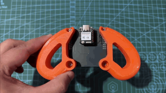

To hold this console ergonomically, we took inspiration from the Sega Genesis Controller and designed two handgrip parts secured using M2.5 PCB standoffs used to connect the two PCB layers.
After finishing the model, the switch actuators and handgrip were exported as mesh files and 3D printed with orange PLA and a 0.4mm nozzle.

  1. Connecting the 9mm PCB standoffs to the top layer of the board via its four mounting holes is how we begin the layer assembly procedure.
  2. The top layer board was flipped, and the two 3D-printed switches were inserted into their designated slots.
  3. Next, the midlayer was positioned from the bottom of the top layer.
  4. We then placed 3D-printed left and right handgrips over the midlayer and secured them with two M2.5 screws to the PCB standoffs.
  5. After attaching both handhrips to the standoffs that connect the top and middle layers of the PCB, we installed the XIAO ESP32 and completed our console assembly.
