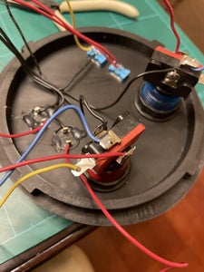

Step 7: Electronics
Now that everything is printed, I started to assemble my electronics. Since I had a lot of space in Main Body 2, I could afford to mount everything on a large breadboard. I followed the circuit diagram from Lunchbox7895; Linked is their GitHub that includes their circuit diagram and a mockup in Fritzing. Make sure to make the wires for the LEDs are extra long so you can mount them on the breadboard while the it's outside of Main Body 2. It'll also generally make your life easier, since you will have solder a Neopixel to another Neopixel while assembling.
Above is an annotated image of my wiring, in case you need more references. Please note that I chose to forego the three red LEDs that Lunchbox7895 included.

I designed my cap to the dimensions of my buttons and switches, so most of them friction fit for me. I hot glued the red and black buttons because the fit was a bit loose. You can do the same if needed. If the fit is too tight, sand down the holes. Usually, arcade buttons include fixing rings to hold them in place, but if they do not, some hot glue should also work. Make sure to solder them before mounting them for your own sanity.
Mounting Electronics
All of the Neopixels don't need any glue to snap right into their mounts, but you will either need to use screws or glue to mount your speakers to the speaker grills. I included holes that were already present on my speakers with the intent of using screws, but I found supergluing to be a much easier endeavor.
