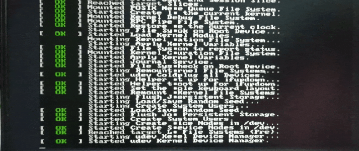

Once the installation was complete, I inserted the microSD card into the Raspberry Pi Zero 2W and powered it on. RetroPie booted up, and I was ready to configure the system for my handheld gaming console.

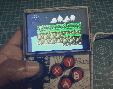

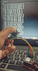

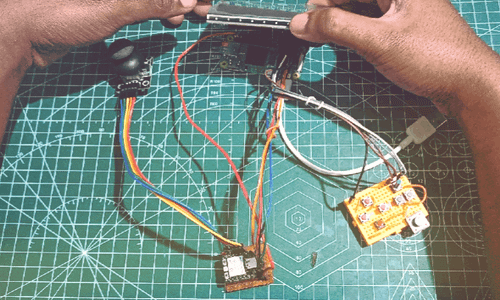

Initially, I used tactile switches for testing the controls. For the final build, I switched to push buttons for better convenience and durability. However, I faced a shortage of push buttons for the D-pad. Fortunately, I found a joystick module in my components box and decided to use it. Since the Raspberry Pi doesn’t support analog data via GPIO pins, I used an ESP32C3 microcontroller to act as an analog-to-digital converter.
First, I calibrated the joystick module to ensure accurate input. I connected the joystick module to the ESP32C3 microcontroller and then interfaced the microcontroller with the Raspberry Pi. This setup allowed the joystick to function as a D-pad, providing precise control for my games.
Step 4: Testing the D-pad Module
After setting up the joystick module, I needed to test its functionality before integrating it into the final build. I connected the joystick module and the ESP32C3 microcontroller to the Raspberry Pi. Then, I launched a game in RetroPie to test the directional inputs and ensure that each movement corresponded correctly to the game controls. I made any necessary adjustments to the calibration until the joystick module worked seamlessly as a D-pad.
Step 5: Testing the Complete Circuit on a Breadboard
Before assembling the components into the final enclosure, I tested the entire circuit on a breadboard. I connected the Raspberry Pi, 3.5" TFT LCD, push buttons, joystick module, and ESP32C3 microcontroller on the breadboard. After powering on the Raspberry Pi, I verified that all components functioned correctly together. I ensured that the display showed the RetroPie interface, the buttons responded accurately, and the joystick module worked as a D-pad. This step was crucial to identify and resolve any issues before final assembly.

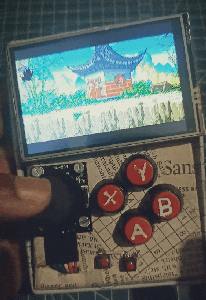

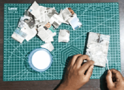

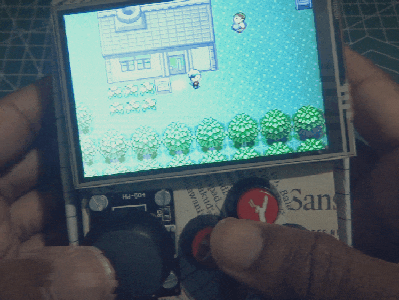

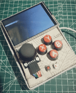

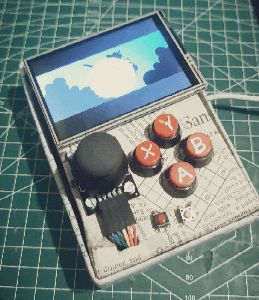

To create the enclosure for my handheld console, I used cardboard reinforced with glue and old newspapers. First, I cut the cardboard to the desired shape and size to fit all the components. I mixed glue and water to create a paste, then applied it to the cardboard and covered it with layers of newspaper. This technique strengthened the cardboard, making it durable enough to protect the components. Once the glue had dried and the cardboard was sturdy, I assembled the circuit directly onto the cardboard. I ensured that all components, including the Raspberry Pi, LCD, buttons, and joystick, were securely attached. This approach provided a simple yet effective enclosure for my handheld console.

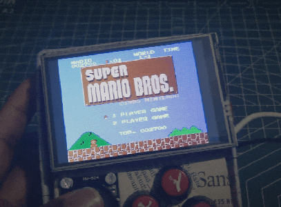

Step 7: Final Product

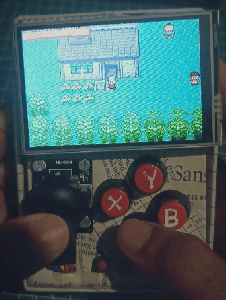

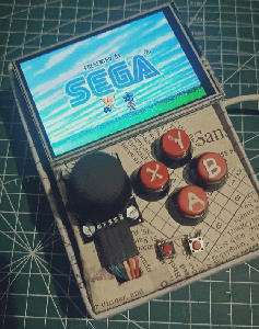

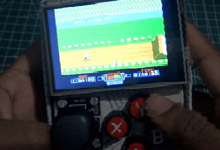

With the enclosure complete, I assembled the final product by securing all components in place. While integrating an inbuilt lithium-ion battery would have been ideal, I initially used a power bank to power the console. This setup was functional and convenient, allowing me to enjoy my games without worrying about an internal power source.

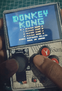

To test the final product, I connected the power bank to the Raspberry Pi via a USB cable and powered on the console. The power bank had enough capacity to provide sufficient runtime for my gaming sessions. I played a variety of NES and GBA games, including "Pokemon Emerald," "Dragon Ball Z," "Super Mario," "Contra," "Zippy Race," and "Donkey Kong." The console performed well, and the gameplay was smooth and responsive.
Although the console did not include built-in speakers, it was able to connect to Bluetooth speakers and earphones for audio output. This added to the portability and convenience of the handheld console, making it a truly versatile device for retro gaming on the go. The final product was a satisfying culmination of my efforts, combining various components into a functional and enjoyable handheld gaming console.
