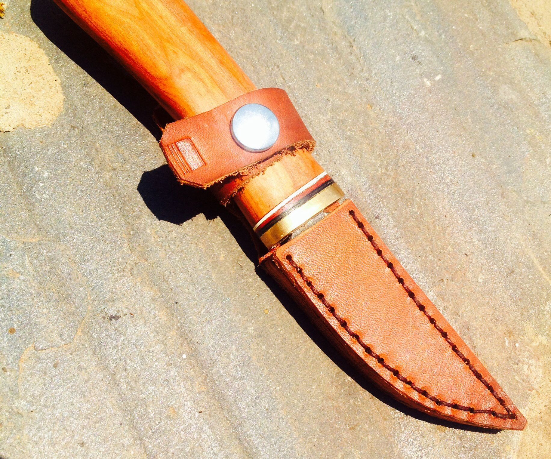

Step 1: About Bamboo
Bamboo is a really beautiful and strong material for wood working. The fibers can sometimes cause trouble if you work them recklessly, but it is also the fibers that make the material beautiful.
This handle is sitting on a knife but you could easily adapt it to other things you need to get a handle on! Maybe a door or a a stickshift car or.... ok, so maybe there are not THAT many things which need bamboo handles. But if there is a will, this is the way to do it!
