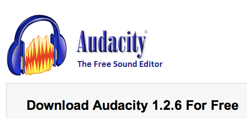

Step 4: Capture With Audacity
Open source software like Audacity can capture waveforms to a magnitude of +/- one.
What a digital +/- one value means in terms of input voltage may not be standard.
But calibrating the input of a laptop can be done to some precision.
