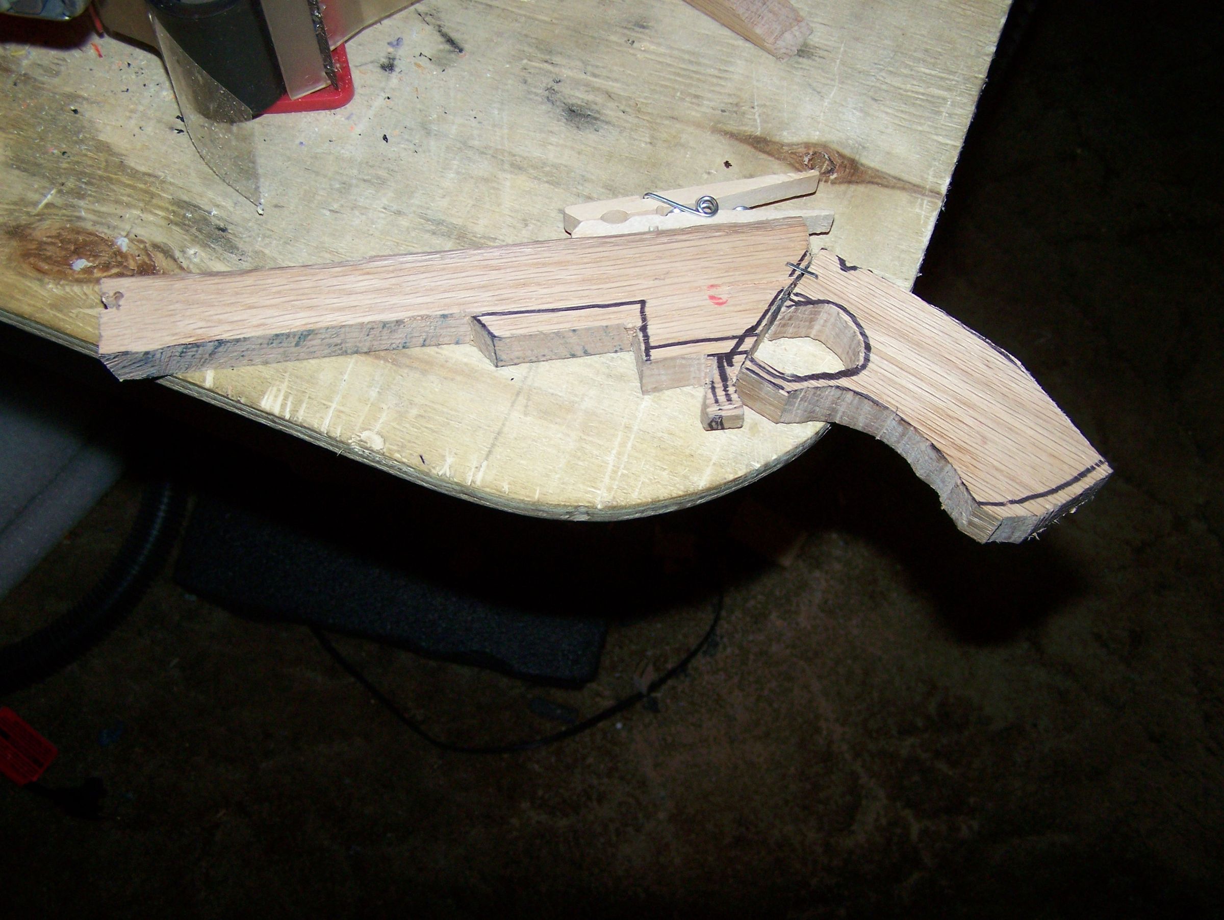

Step 2: Cut the Stock
Yep, you got it. Now you get to cut out a stock you find comfortable. Note my lacking of telling you the lengths of any of this yet? There's a reason behind it: every human is different, and what I like and what you like will be different. You see, what I like is bending my elbow in while shooting to raise my sights (almost literally 'iron' sights) to my eye-line so I can shoot. I also don't mind slightly odd positions with the fingertips (note the bends on some of them in the pictures)
So, what to do?
1: hold the wood and make your mark with the marker. I like my old sharpie for a reason.
2: grab your favorite saw. This can be a miter saw if you don't mind noise.
3: begin cutting. This could either take a mere handful of seconds up to a half hour, depending on your method. (hint: when possible, electricity beats hand power every time.)
4: repeat process until satisfied.
In my case, I decided to 'dremel burn' the back end with a sanding disk. I thought it looked somewhat cool and it rounded the edges. Not to mention giving it a look of being battle worn.
Also, note that you might have to change your stock slightly as you go, as far as cutting some parts out of it to allow other pieces to join up. I had to as well with my 2 piece stock, but was satisfied with the result.
