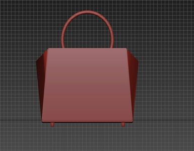

to me the form of the bag is crucial, I start of with base block out the shape of the bag in 3ds max. the polygonal modelling method allow me to tweak the angle of the fold and the taper amount. the handles are roughly modelled to make sure it is proportional to the bag. The model is fairly simply. once I have the shape and form correct I started to play with the offsets.
In order to stitch the leather in layers later on. the model needs to be off set so there is gaps in between two pieces of patterns. this gap ensure the thickness of the leather can be added to the pattern so when stitching there won't be to much stress on the leather and therefore keeps the shape and form of the bag, it will last longer ultimately. Also make sure the areas of the pattern needs to be overlapped so there is enough leather for the diamond punch to set up holes. The feet are longer than most of the commercial available bags. the feet keeps the bag elevated and ensure the white leather doesn't rub the ground and get dirty. There is alot of trial and error when making this. and I took extra attention to make sure the pattern is suitable for leather.

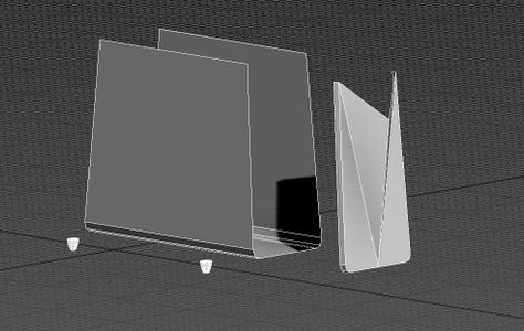

Once the pattern is made on 3ds max, I began to transfer polygons to actual patterns
1. the flat surface area ( front and back ) is exported to DXF file and later on edited in Adobe Illustrator.

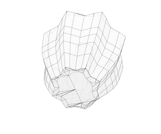

2. the folded and curved area is exported to OBJ and later on imported to Papakura to make them into paper Patterns
3 the feet are exported to STL files and go straight to 3d printing softwares.

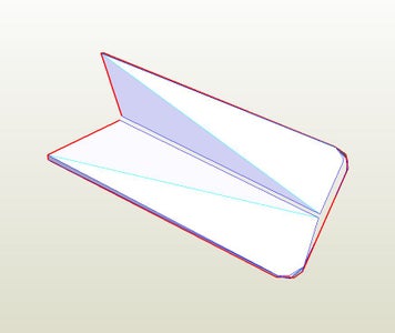

I imported the side pattern to pepakura and unfolded to reveal all the fold lines. Then print it to be used later.

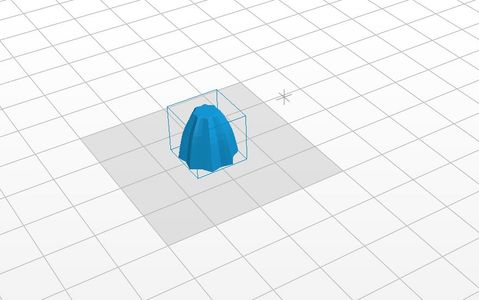

The feet and printed on my Zortrax M200 with white Z-Ultrat material.

The side of the bag has folded lines so when using it the bag is not wide open. to make the folds precisely, I printed out the fold pattern which I imported to Papakura, in Papakura the folds are generated to mountain and valley. Carefully trace all the marks on the veg tan leather then score the leather with awl, and light cut the marks open, I used a grove cutter to take off some materials on both sides this will ensure the leather can be folded easily. I also used bevel tool to gradually shave off some materials near the grove, so the fold lines are not too harsh. the veg tan is then hammered and clamped to form the shape i want. Wrap the white leather on top of the veg tan leather while it is still in folding position can further fortify the fold shape and make the bag naturally stay folded and closed. The edges are all burnished and treated with gum Tragacanth for a clean and smooth edge.

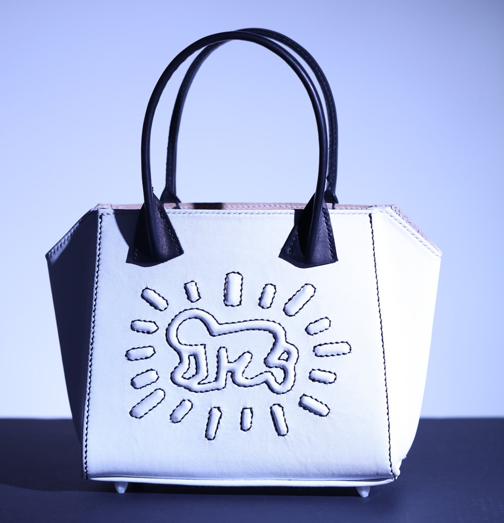

attach the sides to the front and back, then start stitching from the middle of the bottom, this way the fold line will be in the center. when reached the round corner the the outside leather ( front and back ) will have one punched hole that is not aligned with the inside leather ( side) . this can be fixed by warp the thread around the extra punch and move to the next on. the blue and red diagram will explain better. Once all the stitching is done I trimmed off all the excess threads and press the bag into the desired shape.
Step 12: Complete

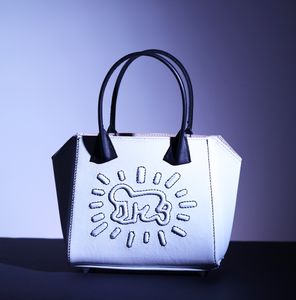

The complete bag has a beautiful texture and well made quality. I think it rivals commercial designer bags and to some extend even better because it is one of a kind and there is no second one. I gave it to my girlfriend as a present and she loved it. I loved the process even more. I think I am going to create another bag after this and give it to my mom. the accomplishment of making something beautiful and also can be appreciated by others is wonderful. There are a few mistakes that I made while making it, but it will only lead to a better crafted bag next time.
