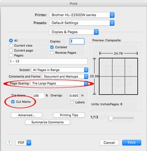

The patterns are included and they are full sized and ready to print. The file is attached in the end of this step. Click it to download it to your computer and then open with an Adobe Reader which you can download for free here:
https://get.adobe.com/uk/reader/otherversions/
Any home printer will do the job. You would need to tick the "Tile large pages" option so it is printed in original size at original scale and the "Cut marks" option . Then assemble the printed parts and glue them together connecting the cut marks. Cut the patterns out of paper.
