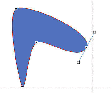

- Create a "Boomerang" by inserting a Curve shape. Powerpoint will display a Cross cursor; add 4 arbitrary points by clicking the mouse button, then a 5th point on top of the first point in order to close the shape.
- Reshape the Curve shape into a "Boomerang" by right-clicking on the shape and selecting Edit Points.
- Drag the points to the desired shape. Adjust the point's curvature by rotating and resizing the adjustment line, as shown in the attached pictures.

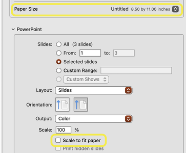

This is the step in which that I had most difficulty. I wanted the clock face diameter to print out at 4 inches, which is the size that I created the circle in Powerpoint, but when I printed it out, it was either too large or too small. One obvious setting to change is to turn off "Scale to fit paper" in the "Print..." dialog. After turning this option off, the size was still wrong. It turned out that even though the selected paper size was 11" x 8.5", there was a margin associated with this paper size, and the image was scaled to accommodate the margin. To fix this, I created a Custom Paper Size in the "Print..." dialog under "Manage Custom Sizes..." with 0" margins (see attached screenshot).
Print the artwork with the above settings.

I had difficulty printing the design at the desired size. I use a Mac, so this may just be a Mac issue. I found that Powerpoint/Mac was scaling the image when there was a margin defined in the paper size. To fix this problem, I made a custom paper size without margins.
