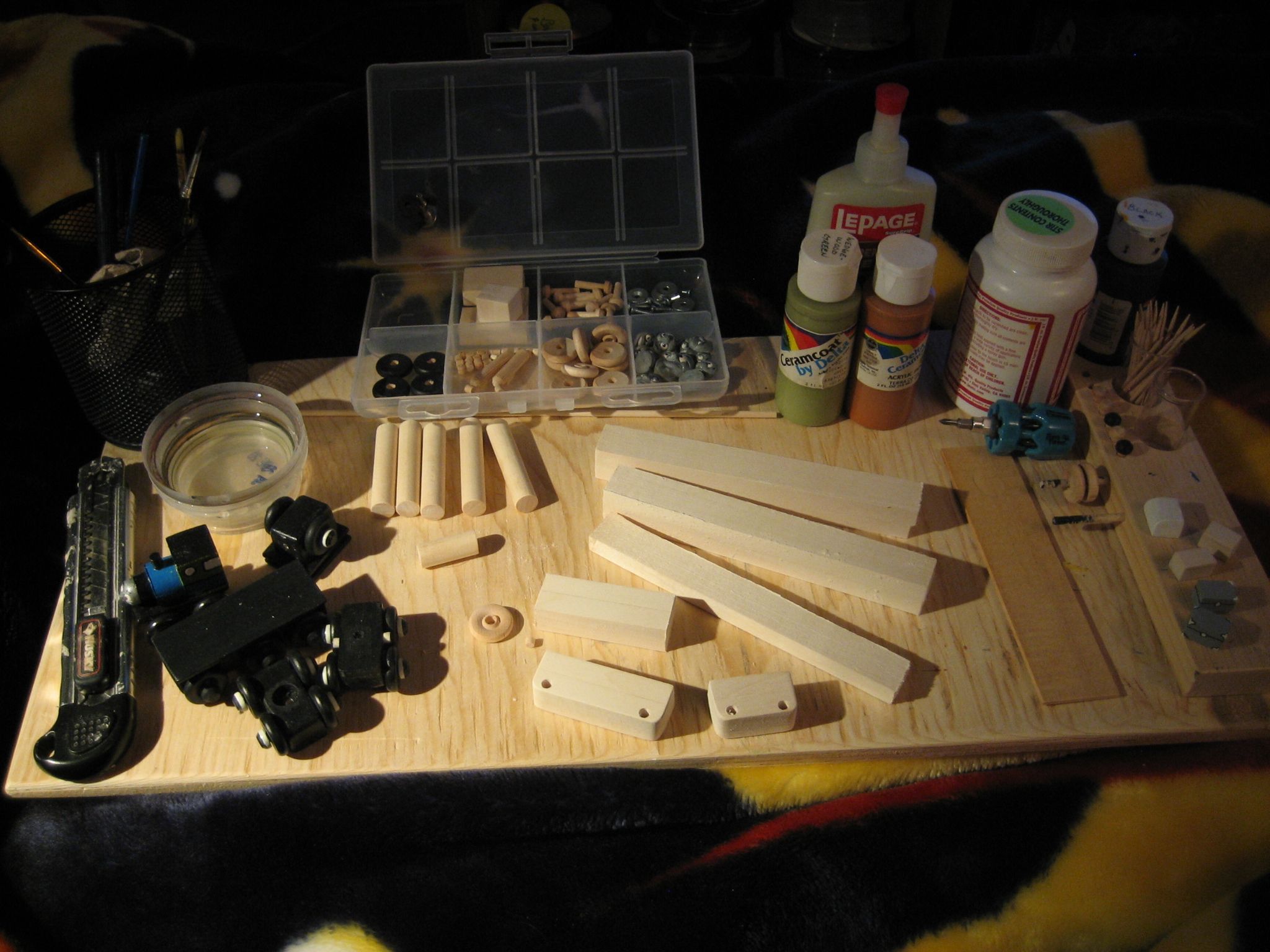

Step 1: Tools and Materials
The tools required for this project:
Drill press
Drill Bits - 1/4" and 1/2"
Table saw
Sandpaper (Medium fine works well - 100 or 120 grit)
Square
Clamps
Scroll, Jig or Band saw, whichever you prefer...or a coping saw if you are oldschool.
Materials needed for this project:
Basswood 48" x 5" x 0.5" (about $5 at your local craft shop)
1/4" dowel 4" long (the small wood pegs from Ikea furniture work well, if you have any leftovers)
1/2" dowel 2" long (I used the handle from a cheap foam paintbrush)
Acrylic Paint and Varnish
Paintbrushes
Sharpie Markers (thick and thin)
Wood glue
Brown paper bag
I found it really useful to have a piece of standard track for setting up the saws and testing sizes. If you are making this toy for somebody else and don't have track pieces laying around, you can pick one up at most good toy stores for under $2.
