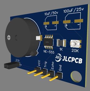

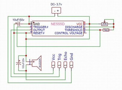

Step 4: Schematics and PCB Design
The schematics of PCBs can be seen above.
Step 5: Circuit Connection – Step 1
To make this circuit, we need to follow a normal method of this time IC. 1st we need to connect 2 and 6 no leg of timer IC-NE555. Then we connect 4 and 8 no leg of NE-555 timer IC. It is a common connection for NE555 IC circuit.
Then we connect 10µf/50v capacitor negative leg with 1no leg of timer IC and connect it’s positive leg with 4no leg of timer IC.
Step 6: Circuit Connection – Step 2
Now we connect 100µf/25v capacitor positive leg with buzzer positive leg and connect capacitor negative leg with buzzer negative leg.
This is a parallel connection between capacitor and buzzer. Then we connect capacitor positive leg with 4no leg of timer IC.
It is the time to connect 1 kΩ resistor with the circuit. We connect this resistor with 6 and 7 no leg of timer IC.
Thanks toJLCPCB,for provide us such a quality PCBs.
Step 7: Circuit Connection – Step 3
This time we need to connect Potentiometer with the circuit. We connect potentiometer Vcc leg with 8no leg of timer IC. And then connect timer IC 7no leg with GND and Output leg.
Now we connect power source with the circuit. We are using DC 3.7v battery with the circuit. Connect battery positive cable with 8no leg of timer IC and connect battery negative cable with 1no leg of timer IC.
Step 8: Circuit Connection – Step 4
This is the final step of this ultrasonic circuit. Now we just need to connect sensor with the circuit.
Follow the steps below -
  • Vcc leg with 4no leg of timer IC
  • Trig leg with 3no leg of timer IC
  • Echo leg with buzzer negative leg
  • Gnd leg with 1no leg of timer IC
