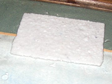

Step 3:
Place your tulle-scrubbing pad paper side down onto your couch (the thingy you let the paper dry on).
Most instructions suggest felt, a wool blanket, a reusable wiping rag, or construction paper. The photo shows me using glass in hopes of getting a smoother surface, a sad mistake (think 'superglue'). I ultimately found success using a bath towel covered by a flour-sack dish towel covered by another layer of tulle.
Press lightly to adhere the paper to the couch. Hold the tulle down with the fingertips of one hand, and peel the scrubbing pad off the tulle.
Set the scrubbing pad aside, and then gently peel the tulle off the wet paper you've just made. Start with one corner: if the corner of the paper comes up, try another corner.
When you've filled the towel (I got 20 small sheets on mine), slide the tulle (I had help) onto a dry towel, and let the paper air dry overnight.
Apologies for the photos showing me couching onto glass: really - do it onto tulle-covered towels. I'll try to get better photos up in a day or two.
