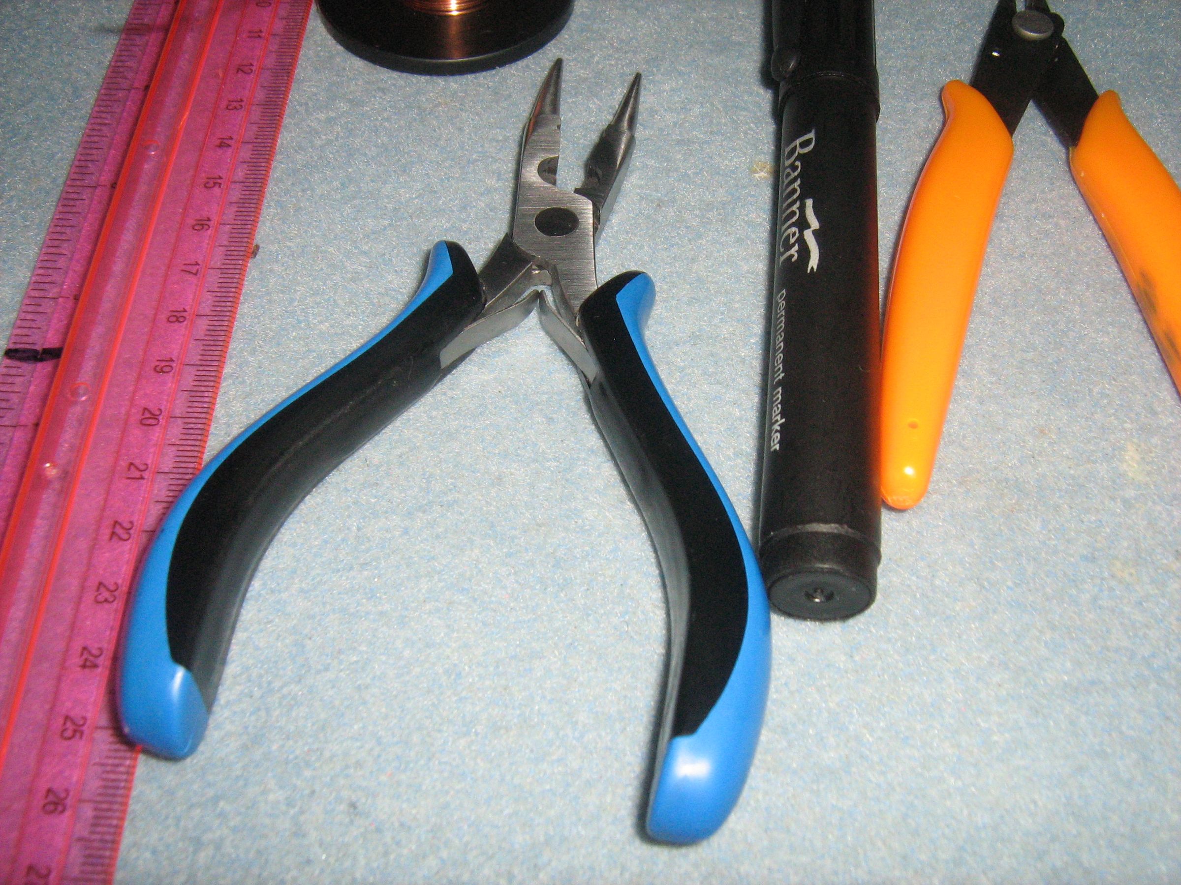

You will need.
18 or 20 guage wire.
Round nose pliers
Cutters
Jaw nose pliers
You will need.
Round nose pliers
Cutters
Jaw nose pliers
Step 1: Form a Loop
Stretch your wire using a jaw nose pliers, if you don't have one you can use a cloth or even your fingers.
Form a tiny loop using the small part of your round nose pliers.

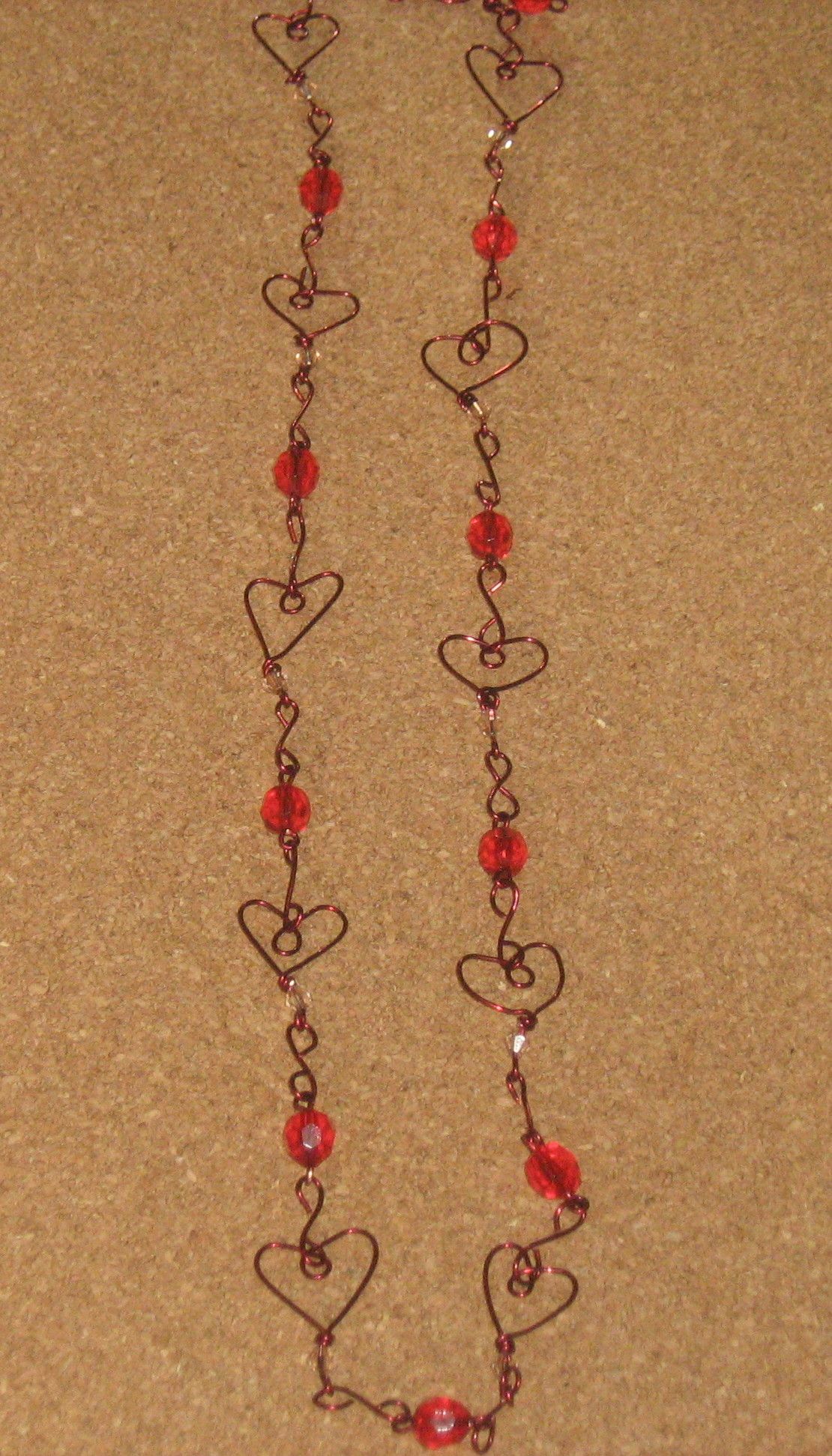

Step 8: Example of a Finished Necklace
Here is a necklace I made with the links incorporated with beads. I hope you enjoy the tutorial.
