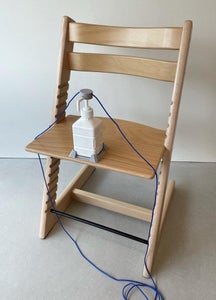

This is the jig that allows you to operate your sanitizer with your feet.
The existing Chair/Desk/Wagon will be a foot-operated sanitizer stand!
You can disinfect your hands safely.

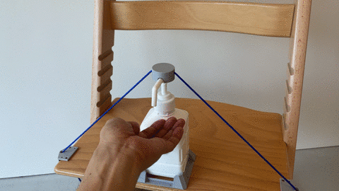

Step 1: Stick the Bottle Base
Put double side tape to the bottle base and stick it to the chair/desk/wagon.
Step 2: Install Rope to Pump Head
Make a knot in the middle of rope.
Install the rope through the pump head.
This will keep the rope position.
Then place the bottle to the base.
Step 3: Cable Guide
Place cable guide on the side of desk.
Double sided tape should be enough.
Use screw if tape doesn’t work due to rough surface (There is 3 and 5mm hole).
Prepare 2 or 4 each depends your desk shape.

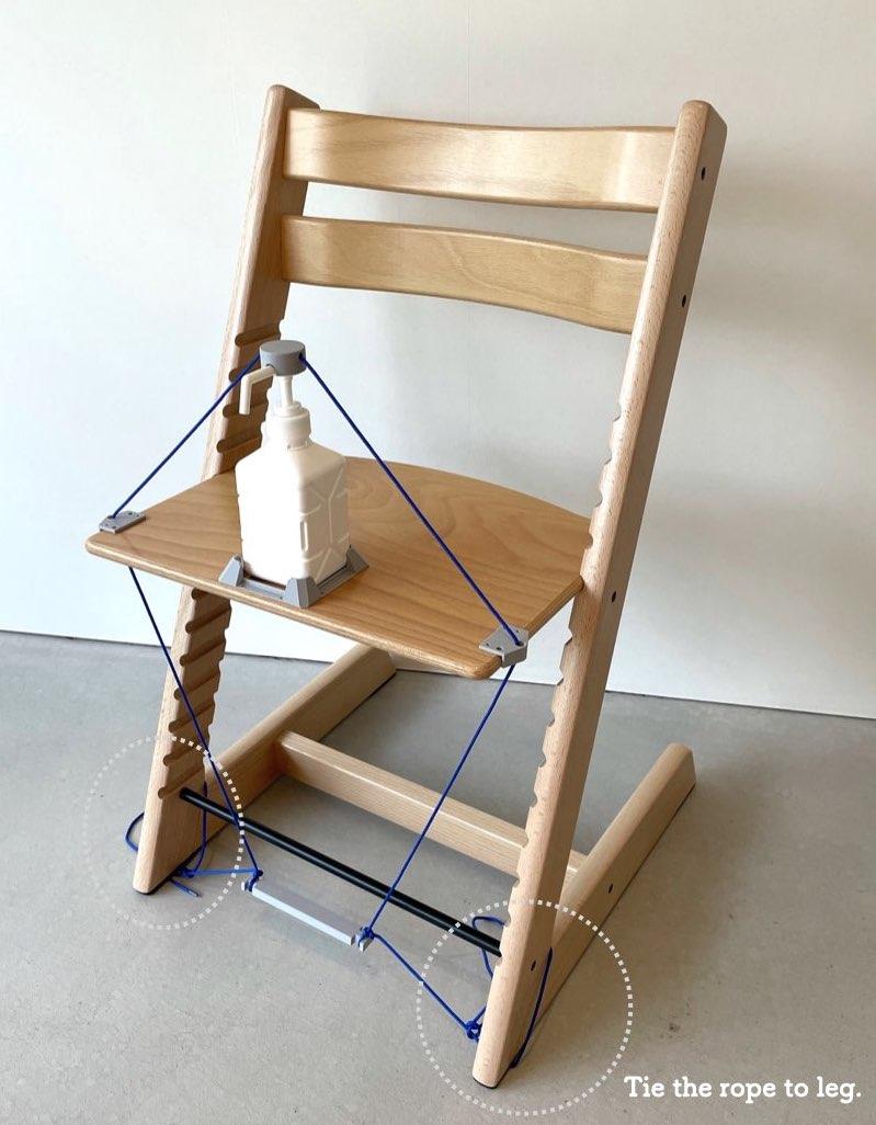

Step 4: Pedal
Hold it with a rope (Marlinespike hitch) 5cm from the floor.
Tie the rope end to the chair/desk/wagon leg. It holds the pedal in position and prevents it from shaking.

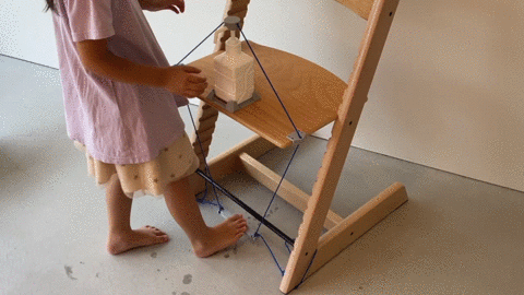

Step 5: Let's Use It!
Step on the pedal and disinfect your hands.
This instruction use chair for the stand but you can use desk or wagon or any!!
