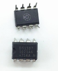

Step 1: DS1307 Features
  • 56 bytes of non-volatile RAM
  • two-wire serial interface
  • Programmable square wave output
  • Automatic power-off detection and switching circuit
  • In battery backup mode, power consumption is less than 500nA
  • Industrial grade operating temperature: -40 to 80
  • 8-pin DIP and SOIC packages
  • It can count seconds, hours, minutes, days of the month, months, and days of the week, and has a leap year compensation function. The annual limit is 2100.

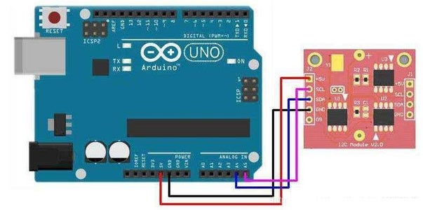

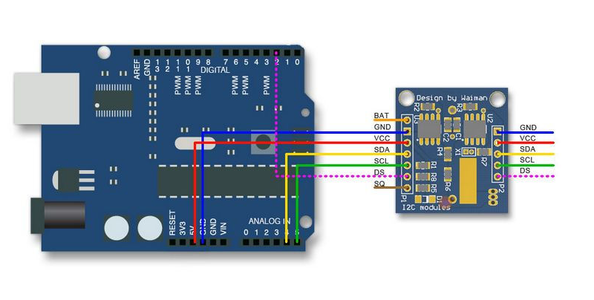

Step 3: Module Wiring Diagram
