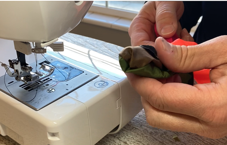

Start by creating and affixing what will become the closure (the small piece measuring 2 1/2" x 2"):

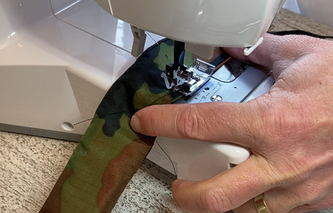

  1. Fold lengthwise with right sides together (so that the little piece now measures 2 1/2" x 1")
  2. Stitch along raw edges (or long side) with 1/8" seam allowance

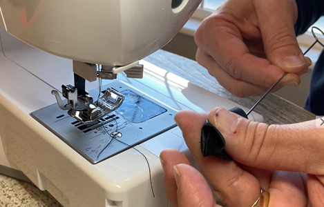

  3. Using turning hook, turn right-side out
  4. Roll the piece in your hands to position the seam in the middle of the closure
  5. Top stitch each long side (about 1/16"-1/8" from edge)

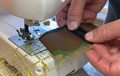

  6. Pin the closure onto the right side of the outer fabric; 1 1/4" from the top, then stitch or baste it into place using 1/4" seam allowance

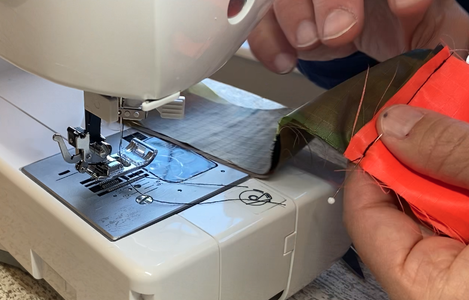

  7. Place the two pouch pieces (the ones measuring 2 1/2" x 22") with right sides together, then sew the two short sides on each end together using 1/4" seam allowance (keep the right sides together for the next step)

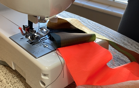

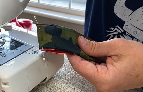

  1. Place two pins on each edge 5 3/4" from the end that does not contain the closure

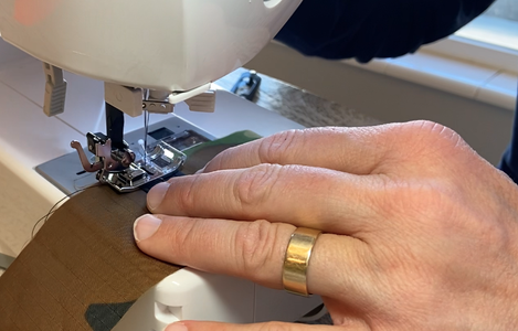

  2. Stitch along each side from the pin to the end (the one that does not contain the closure) using 1/4" seam allowance
  3. Remove the pins
  4. With this step done, you have created a loop in the remaining fabric

  1. Place the seam on the end up to the flap stitching from Step 2 (where the two pins once were)
  2. When you do this, the outer fabric and the liner fabric will face each other, with right sides together
  3. Line up the seams and pin the seam on the loop to the seam at the base of the flap

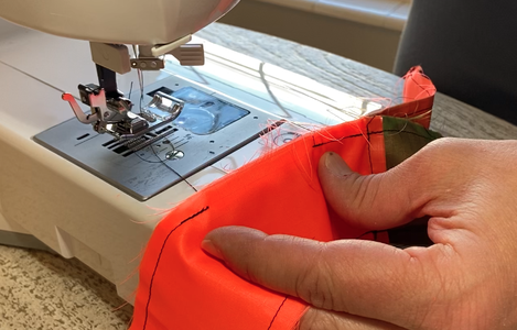

  4. Stitch from the seams (where you pinned) along both edges of the outer fabric using 1/4" seam allowances (be sure to not cross the seam)
  5. Repeat the same process for the liner fabric, but along one of those sides, leave a 2" gap (not sewn)

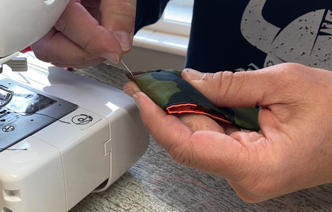

  6. Clip the corners
  7. Pull the pieces through the 2" gap to turn them all right-side out

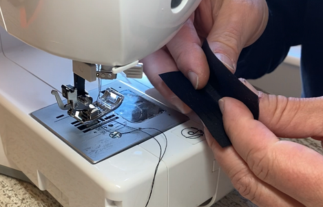

  1. Press the lanyard fabric in half lengthwise, then press each side toward the center fold so that the lanyard is approximately 1/4" wide
  2. Topstitch as close to the loose edge as you can

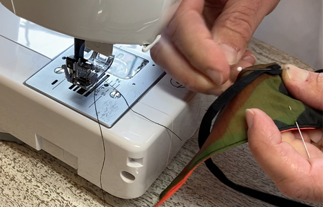

  3. Fold and press each end approximately 1/2" from the end (be sure the ends are pressed in the same direction)
  4. Pin the folded back ends on the back side, at the top of the utensil holder (just below the line where the flap will fold down)
  5. Attach each the lanyard with a zig-zag stitch
