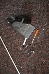

Step 1: The Materials
i picked up a 10 foot length of 1/2 inch conduit, 12 conduit clamps and some 1 1/4" heavy duty plumbers tape from the electrical shop

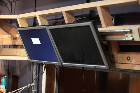

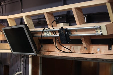

Step 2: The Build
i attached the conduit to the overhead using the clamps. the conduit was set in paraell about 3 inches apart. i had to raise it off of the 2x4 using 5/8 inch plywood. this allowed a gap for the monitor hangers..

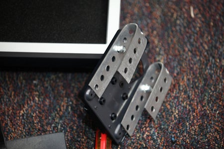

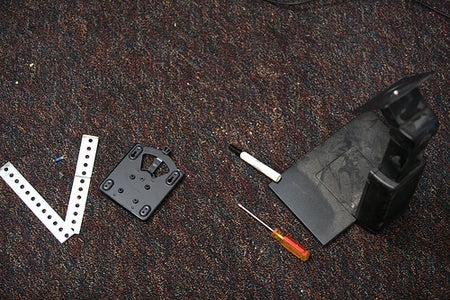

Step 3: Attaching the Monitors
the monitors seem to have a back plate with a VESA 100mm x 100mm plate for attaching them to the table stands, i removed the plate.
then i took the plumbers tape and bent it into a hook shape and attached the new hooks to the back plate..

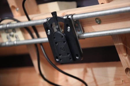

Step 4: Hanging the Monitors
with the conduit rails up and the hooks attached to the back plate, the back plate fit neatly on the rails. the bolt protruding to the rear allowed for the plate to be locked to the rails while allowing it to slide freely along the rails.
Step 5: Attaching the Monitors to the Plate.
the monitors i am using are a 24 inch HP type, this is super conveinient as the monitors can simply be slid onto the plate..
