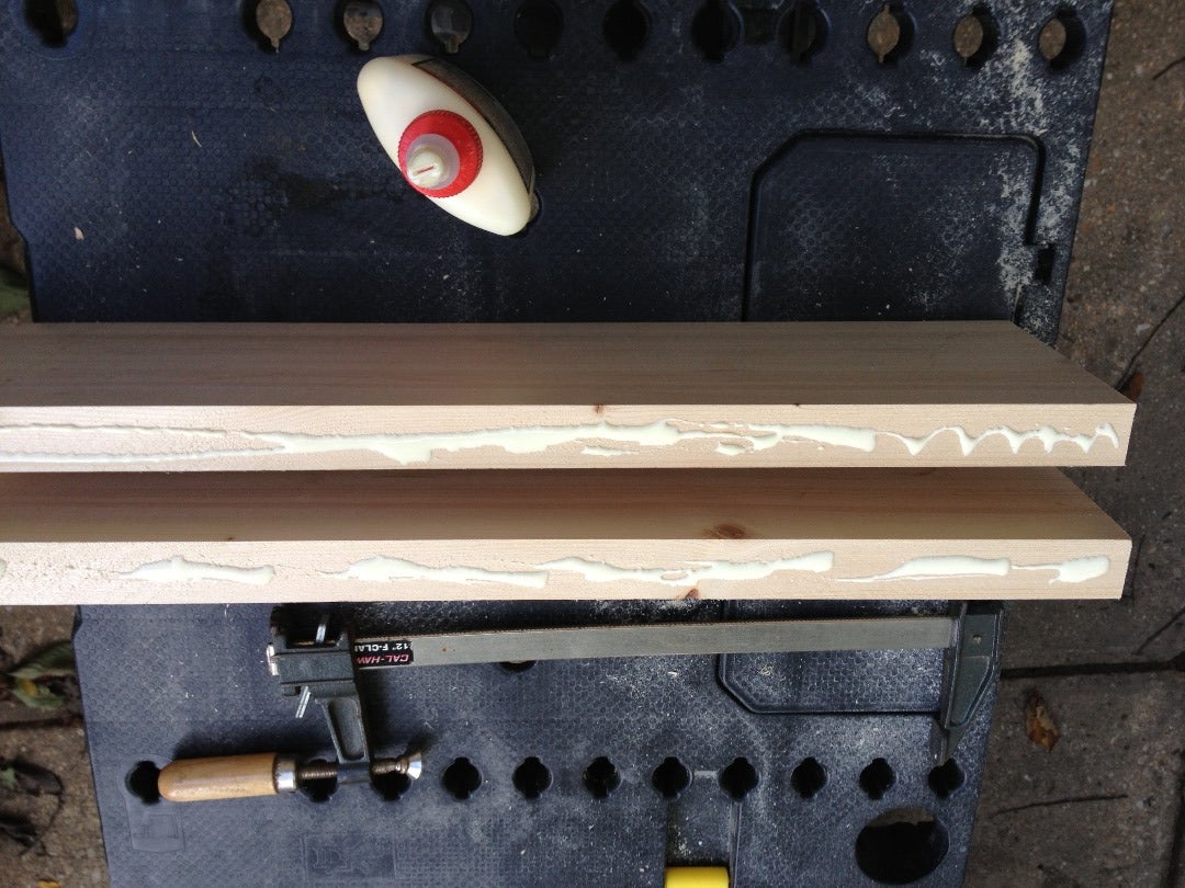

For this project, all of the wood was recycled. I was renovating a closet took out all of the old paper wrapped shelves. I removed the paper and then glued different board together to make wider. To do this, I slightly scored the end of each board the full length of the board. I put wood glue same edge and then pressed the boards together with arms clamps. Once I had the boards clamped together, I took a damp paper towel and wiped the excess glue that had pressed out of the binding area. Removing the glue while still wet is easy. Waiting to remove it until it has already dried requires lots of sanding, and can discolor the wood. The small areas with dried glue also won't absorb stain as well.
When picking which board to put together, I tried to make sure (as much as possible) that the grain and color were similar so that, once glued, they looked like the same board.

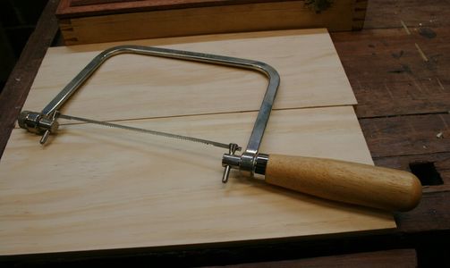

Once I had traced all the pieces, I used a coping saw to cut out the individual pieces. This can be done more quickly with a variety of power/electric saws, but I wasn't in a rush, and sometimes I like the time and repetition of old hand tools. The claw was particularly hard because it was so small to cut out. I had, at one point, to hold it with hand clamps will sawing it.

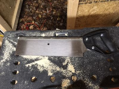

In order to mark the placement for the claws, I first had to mark how the arms and legs would be placed on the body section. I placed all appendages where i wanted them on the body, and marked the places lightly with a pencil. Do not mark too hard or you can indent the wood. This takes significantly more sanding to remove. Once the arms and legs were placed where I wanted them, I place the claws at each end and marked the placement lightly with a pencil. I then used the hand saw from my mitre box to cut out groves at the end of each appendage. Once the grove was cut out, I used a thin squared file to make sure the grove was even throughout.
