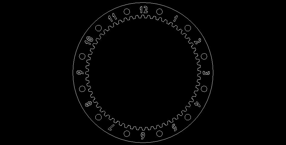

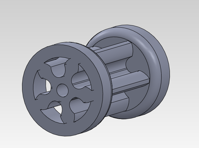

Before I became a robotic engineer I had an internship designing gears. I thought it would be fun to use what I learned for the 3D design contest. This clock all hangs from the top pinion, which is to be driven by the minute shaft of a clock motor (or 1 rev per hour timing motor if you can find one). The minute wheel, counter weighted by a bolt on the back, in turn, hangs from the hour wheel.
The three printed parts to make this are attached as STL files below, if another format is preferred ask in the comments and I will put them up if possible.
