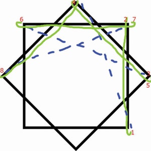

It's finally time to get the yarn! You'll always twist the yarn around the front of each side before leading it to the next side through the back of the mandala. This is what the first row of yarn should look like.
I used my great painting talent :-D to make a color scheme of how the thread should go. I have made only 4 sides in the scheme so the picture isn't too confusing but you'll continue in the same manner for the whole mandala. Green is the yarn in the front of the mandala, the blue interrupted line is the yarn on the back of the mandala and the numbers show you the order of the corners where the yarn should go. (picture 1)
Leave one longer end handing on the back. Twist the yarn once around any pinhead of the upper square and lead the thread to the next corner of the same side of the square. Twist the yarn around the pin in this corner and lead the yarn on the back to the corner on the side of the lower square that's next to the side you were just working on. Continue until the first layer is complete. Twist the yarn around each head just this first time. (pictures 2 and 3)
