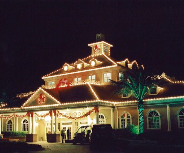

There are some surfaces that are unsuitable for using staples, which makes them ideal for using a hot glue gun. Brick and concrete are surfaces that are perfectly suitable for glue. While it will take a bit longer than stapling, it is still a very simple process to attach each light.
Hot glue is not the ideal choice for every situation. Painted surfaces are one of the surfaces you will want to refrain from living hot glue on, as paint can be damages. On metal, the glue may not stick very well, and on plastic, the hot glue could damage the plastic. Mini lights are not the best choice to use hot glue.
Here are some tips for using hot glue to install your Christmas lights:
  • Take the bulbs off the line until you have install the line. This keeps glue off of the bulbs.
  • Apply glue to the side of the socket, opposite from the clip.
  • Don't apply glue to the socket base, as this can cause damage when you remove the lights.
  • Glue residue will be left behind and, most often, weather and sun will remove the glue residue. If you want to get every bit of glue off, use a hot air gun to soften the glue and then scrape it away.
