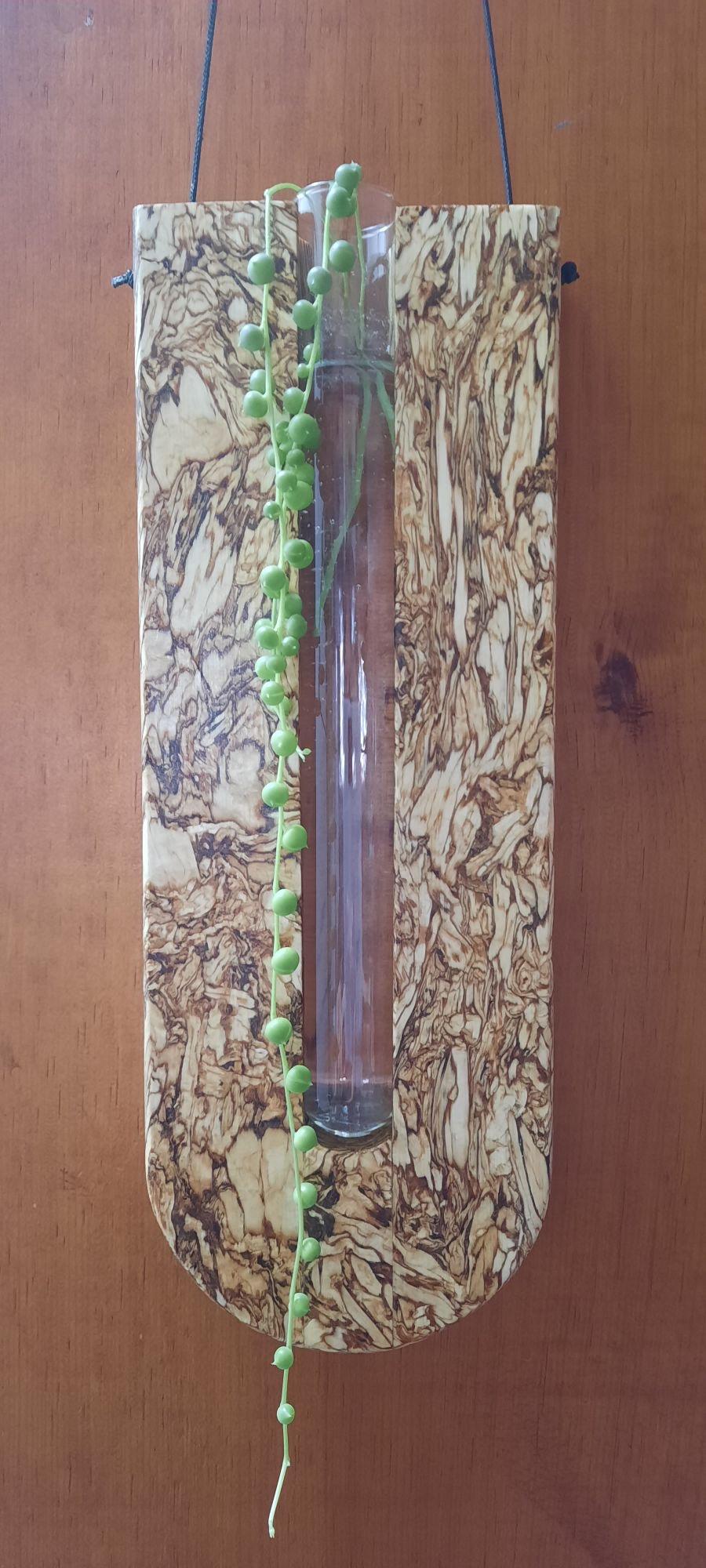

These hanging propagation stations make great gifts whether you do them with a class, or make them yourself.
This is a great intermediate project because it uses a variety of tools for basic and more complex operations. This is one of the projects my advanced wood shop students can choose. These students are familiar with most of the required tools, but I still provide one-on-one support at the table saw and when routing the grooves.
This is a straight forward project, but does requires precision and attention to detail.

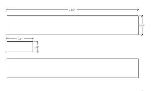

Step 1: Rip and Cross Cut
You will need two strips that are 1 in x 1 3/8 in x 9.5 in. And one strip that is 1 in x 3/4 in x 1 7/8 in.
If you want the grain to match you can cut all these pieces from a single piece of wood that is 1 in x 3.75 in x 9.5 in.
I have students rip and crosscut these on the table saw.
If grain match isn't important, or if you are prepping materials for students who do not use the table saw, you can rip pieces that are 1 3/8 in and 3/4 in and then allow students to cross cut them to length on a miter saw or by hand.
If grain matching, draw pencil lines to help keep track of how the pieces go together.

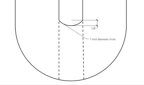

Step 3: Drill Press 1
With the 1 inch forstner bit installed in the drill press, you will set it up to cut 1/8 inch into the end of the middle piece.
Mark the center line of the piece of wood, and mark 1/8 inch from the end.
Use a fence (I made a simple one by gluing a scrap piece of plywood to a sacrificial piece of wood) to align the bit with the center line of the piece of wood, then slide the piece of wood back so the edge of the bit aligns with your 1/8 inch mark.
The pictures probably make this easier to understand than the description.

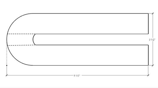

Step 5: Final Shape and Sanding
I have an MDF template for drawing the half circle profile at the bottom. You could also cut out a 3 1/2 diameter circle from paper and use that as your template.
Cut outside your pencil line with the bandsaw, or with a jigsaw (or a coping saw).
Clean up the line on the belt or disc sander.

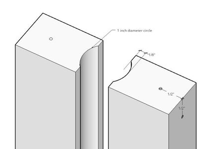

Step 6: Attach the Cord
The holes for the cord can be drilled by hand, or the drill press table can be tilted to 45 degrees.
The hole is centered, and 1/2 inch from the top edge. If drilling by hand, it help to draw the line to help eyeball the drill bits path.
Cut 20 inches of cord and and lightly melt each end to keep from fraying.
Thread through each hole, and tie a double overhand knot in each end.
