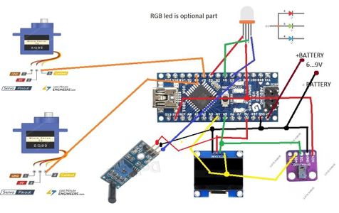

Step 1: Schematic Diagram
Make the connections of the components according to the diagram below.Attention: The RGB LED and the gesture module are powered at 3.3 volts
Step 2: Construction
In this stage, we mount the servo motors on the body of the robot, we fixed the breadboards with double adhesive tape. You can find other fixing methods. We make the connections according to the electrical diagram and fix the wires with clamps. I also fixed the servomotors with double-adhesive tape, as you can see in the video.
