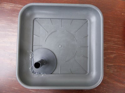

    Step 2: Glue It, Fill It and Install the Bottle
    I glued the plastic spool to the saucer with hot glue. The water can go into the tube and out under the disk.
    The tube is also thinner than the bottle neck, allowing air to go in.

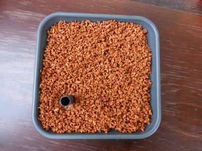

    Next, fill the saucer with some porous material. I used Seramis because I had it available and it looks rather nice.
    The important part is that it is porous and soaks with water, providing a good surface area for the water to evaporate.
    Finally, put the filled bottle onto the tube. The water will start to flow out and bubbles will rise in the bottle until the water level reaches the bottleneck and shuts off the air. If this happens, you have done everything right.
    For the next minutes, the granulate will soak up the water and cause the bottle to bubble a few more times.
