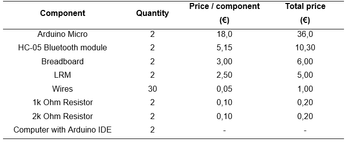

This system involves following hardware and software components:
·       2x breadboards
·       2x Arduino Micro
·       2x HC-05 Bluetooth module
·       2x DRV 2605L drive
·       2x Linear Magnetic Rams (LRMs)
·       2x 1 kOhm resistor
·       2x 2 kOhm resistor
·       Jumper wires
·       2x computers provided with Arduino IDE
An image of the bill of materials (BOM) is provided. Some of these prices are only an estimate, since we had some of the materials already provided.

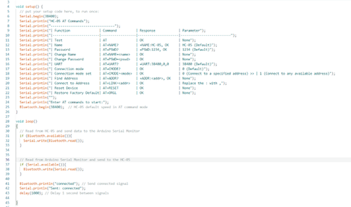

Step 2: AT Commands
The AT commands are used to change the default behaviour and settings of the Bluetooth HC-05 module. To get into AT commands of this Bluetooth module, the HC-05 module must be powered on while pressing down the button on the module itself. The red LED will start blinking very slowly (every 2 seconds). When this happens, follow these steps:
1.    Open Arduino IDE
2.    Upload the program shown in the first figure for both the Arduino’s. This program will check if Bluetooth is available and if so, a message will be sent and read by both the master and the slave.
3.    Open the Serial Monitor by clicking on the icon on the top right corner of the app. Make sure to indicate “Both NL & CR” and to set your transmission rate to “38400 bauds”. These settings are indicated in the second figure.
4.    To check if the module is in AT mode, type “AT” in the message prompt bar of the serial monitor. The app will give an “OK” message back. Next, the settings of the module will be set up. One Arduino will be setup as master, the other as slave.
For the slave configuration, following commands should be entered in the message prompt:
AT+NAME=”name”                 // Fill in a name of choice
AT+ROLE=0                           // Set as slave
AT+UART=38400,0,0             // Ensure baud rate is set to 38400
AT+ADDRESS?                      // Returns the IP address of the slave, copy this address
For the master configuration, following commands should be entered in the message prompt:
AT+ROLE=1                          // Set as master
AT+CMODE=0                      // Connect to specific address
AT+BIND=ADDRESS            // Bind to the slave's address (replace "ADDRESS" with the actual slave's address and replace the ":" by ",")
Now unplug the modules of both breadboards, and immediately plug them back in. If the LEDs of both modules start blinking twice every two seconds, the modules are successfully connected. This could take a few seconds. To double check the connection, both Serial Monitors should see a connection message (of your own choice) being printed.
Note: When the LED begins to blink rapidly, it indicates that the device is in Normal mode. To revert to AT mode, disconnect the Arduino from the computer and reconnect it while holding the button on the HC-05 module down. This process will reset the device to the appropriate mode for further configuration.
Following link, obtained from Aced Inventor explains these steps in a video: https://www.youtube.com/watch?v=I2qFXSe0W3w&t=5s&ab_channel=AcedInventor

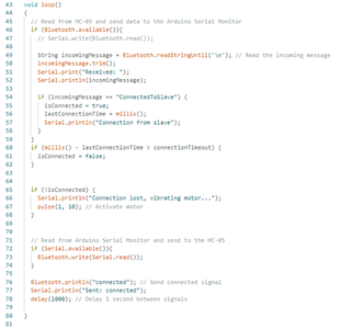

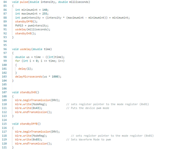

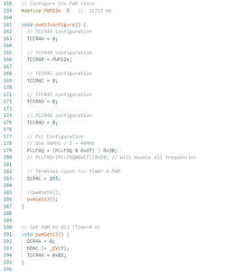

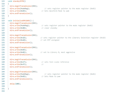

Step 3: Write the Program
For the desired application, two LRMs (motors), each on a separate board, should start vibrating when the distance between the Bluetooth modules become too large and the connection is lost. In our application, the two modules constantly send a message to each other. When this message is lost, the connection is deemed lost and the motors vibrate. The code for both the master and slave is identical, except for the message that is sent, which you can choose yourself. The sent message of the master should be identical to the sent message of the slave, and vice versa. It cannot contain spaces.
Explanation of the code snippets:
1) Initialization:
  • The SoftwareSerial library is used to create a software-based serial port for Bluetooth communication.
  • The setup function initializes the serial communication and sets the pin mode for the motor.
2) Main Loop:
  • The loop function constantly checks for incoming Bluetooth messages.
  • If a message is received, it checks if it is the connection message ("ConnectedToSlave"). If so, it updates the connection status and records the time.
  • If no message is received within the timeout period (3 seconds), it considers the connection lost and activates the motor.
  • It also reads from the serial monitor and sends any data to the Bluetooth module.
  • Finally, it sends a "connected" message every second to maintain the connection, and such that exactly the same can be seen in the slave.
3) Motor Control:
  • The pulseMotor function is used to activate the motor for a specified duration.
