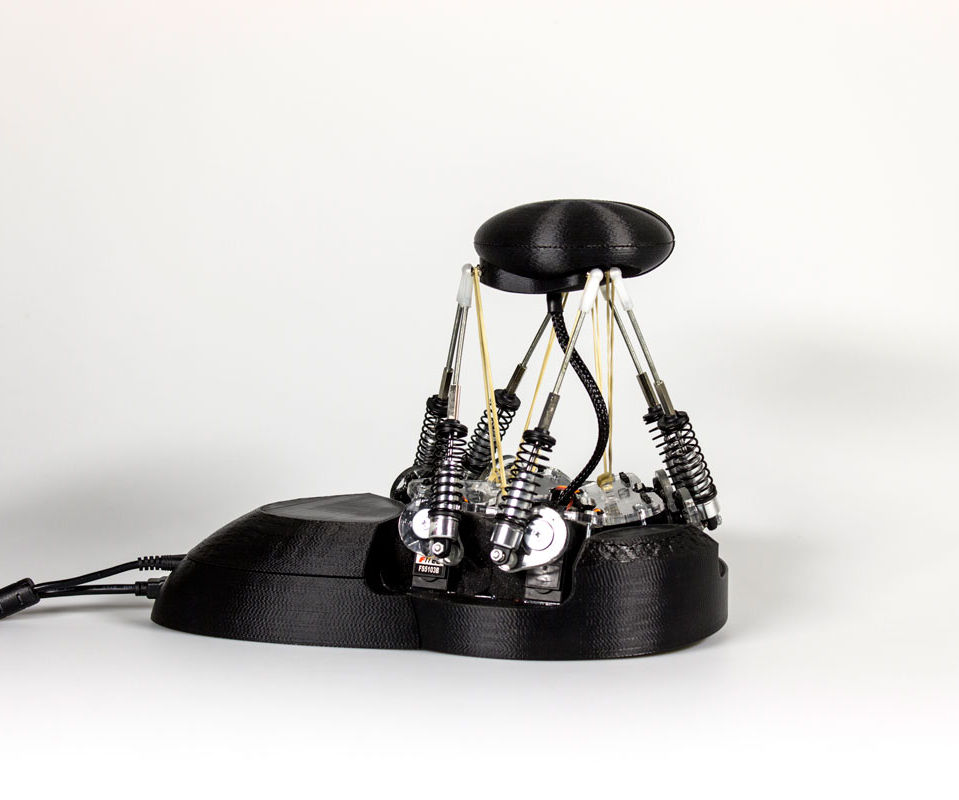

Introduction: Haptic Drawing Robot
As part of my master graduation at the dep. Industrial Design at Eindhoven University, I created a haptic drawing device that can be used to navigate a semi-autonomous car through traffic. The interface is called scribble and lets the user experience haptic fixtures in a 2D space through a variable force and location. Although the concept is not what this instructable is about, you can read more about Scribble here: http://felixros.com/scribble.html
Scribble uses a 5 bar linkage configuration which allows it to move two lateral degrees of freedom (DoF). This setup is fairly popular among prototypers to create drawing robots, here are some examples:

Depending on the purpose you have in mind you should first design a 5-linkage structure. Think about the measurements, actuators you want to use, and how to attach the joints for smooth movements.
For my prototype, I run my code on an Arduino DUE that is controlled over serial by a program on my Mac that was made in Open Frameworks. The program uses a UDP connection to communicate with a Unity 3D based driving simulator.
The Scribble prototype uses 5mm bearings and is made out of 5 mm laser-cut acrilic. The actuators are Frank van Valeknhoef's Haptic Engines that allow for actuation, reading out position, and outputting a variable force. This made them ideal for Scribble's desired haptic properties. More about his actuators can be found here: http://hapticengine.nl
