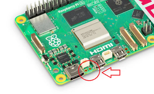

First step is to prepare the Raspberry Pi. In order for the power switch to work we need to solder 2 small pin headers to the unpolulated position on the Raspberry Pi board. You might need to bend the pins outward slightly to clear the NVME hat once its installed.
Once this is done, install the cooler and NVME Hat.

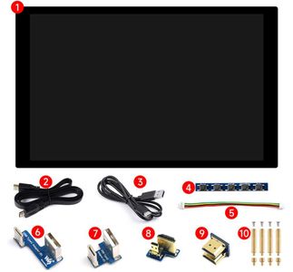

The screen comes with some small brass standoffs, secure these to the screen and mount the Pi so that the USB and HDMI connectors line up and can be inserted. Use 2x M2.5 screws and the ends of the hat standoffs to secure the Pi to the back of the screen.

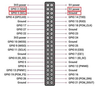

We need 4 Dupont female to female wires to connect 5V, Ground, SDA, SCL these go to PI Pins, 3,4,5,6 (connect later) - THE PICTURE SHOWS THE PINS FROM THE UNDERSIDE.

Connect the 4 Dupont wires as per the diagram to the PIs GPIO header pins (remember - the pins are shown from the underside!)

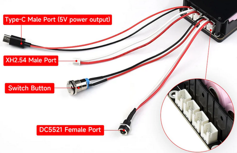

The key switch and power input connectors need to be extended so, since we are not using the original power button, cut and strip the wires from the button, extract the metal pin connectors from inside the JST connector and solder these together, cover with shrink tubing. Do the same for the key switch, using the spare JST connector that comes with the UPS Module.

Connect the JST connectors to power input and power on/off (make sure power switch is off or the Pi will boot)

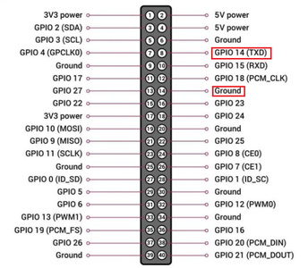

Connect the momentary LED button connectors to the Pi header pins you soldered in the first step, the (-) minus wire to a GPIO ground pin and the LED (+) plus connector to GPIO14 (pin 8 - UART)

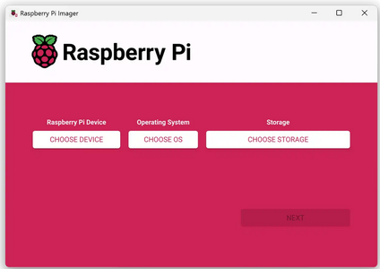

There are plenty of resources to help with installing an OS on the Pi. I have stuck with the standard Pi OS for now. Use Raspberry Pi Imager to download and install the OS. https://www.raspberrypi.com/software/

To enable the LED on the power button, append
enable_uart=1
to the end of the /boot/firmware/config.txt file.
